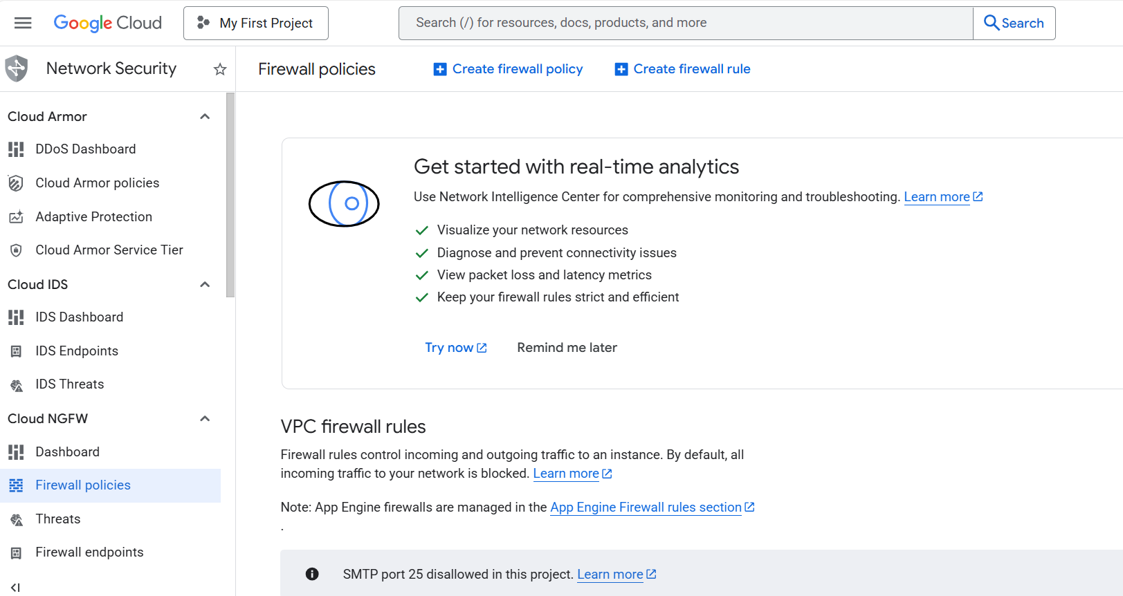

  1. Navigate to the Google Cloud console .
  2. Go to VPC Network > Firewall, then select Create firewall rule.
Image Alt Text:Google Cloud console VPC Network Firewall page showing the Create firewall rule button in the top menu barCreate a firewall rule in Google Cloud Console

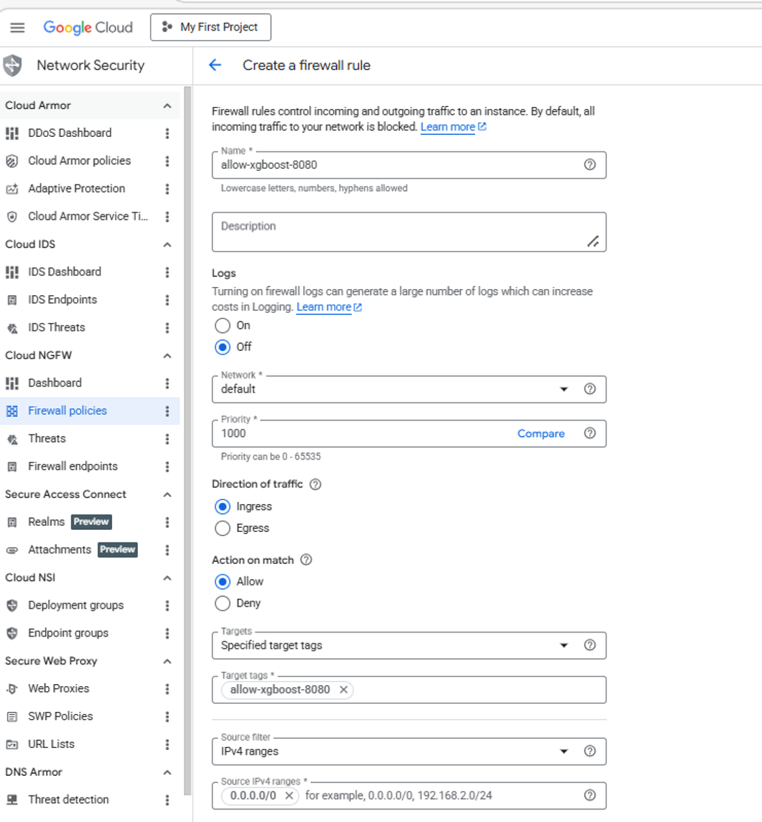

  1. Set Name to allow-xgboost-8080, then select the network you want to bind to your virtual machine.
  2. Set Direction of traffic to Ingress and Action on match to Allow.
  3. Set Targets to Specified target tags and enter allow-xgboost-8080 in the Target tags field. You’ll use this tag when you create a virtual machine in the next section.
  4. Set Source IPv4 ranges to your current machine’s public IP address. Run the following command in a terminal on your local machine to find it:
curl -4 ifconfig.me
Take the returned address and append /32 to convert it to CIDR notation, for example 203.0.113.42/32. Restricting access to your own IP prevents port 8080 from being exposed to the public internet.
Note If your IP address changes or you need to access the API from a different machine, update this field with the new IP address. Using 0.0.0.0/0 opens the port to all traffic and is not recommended.
Image Alt Text:Google Cloud Console Create firewall rule form with Name set to allow-xgboost-8080, Targets set to Specified target tags, and Direction of traffic set to IngressConfiguring the allow-xgboost-8080 firewall rule

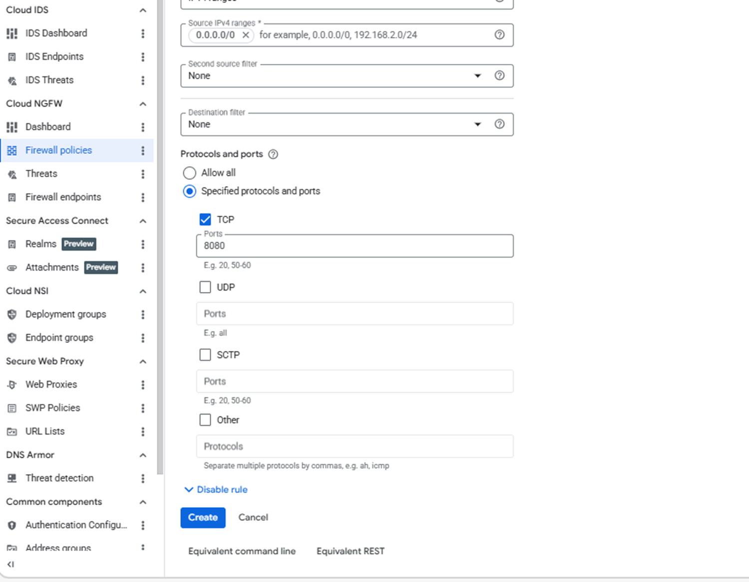

  1. Under Protocols and ports, select Specified protocols and ports.
  2. Select the TCP checkbox and enter:
8080
Port 8080 is used by the XGBoost inference API for browser-based validation and remote REST requests.
Image Alt Text:Google Cloud Console Protocols and ports section with TCP selected and port 8080 enteredSetting XGBoost ports in the firewall rule
