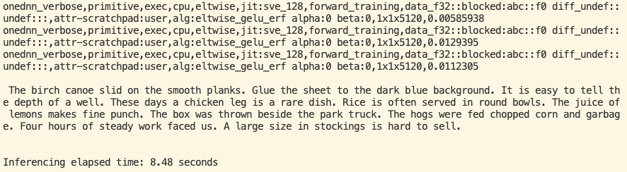

You should see output similar to the image below, which includes the log output, the audio transcript, and the Inferencing elapsed time.
You have now run the Whisper model successfully on your Arm-based CPU.
