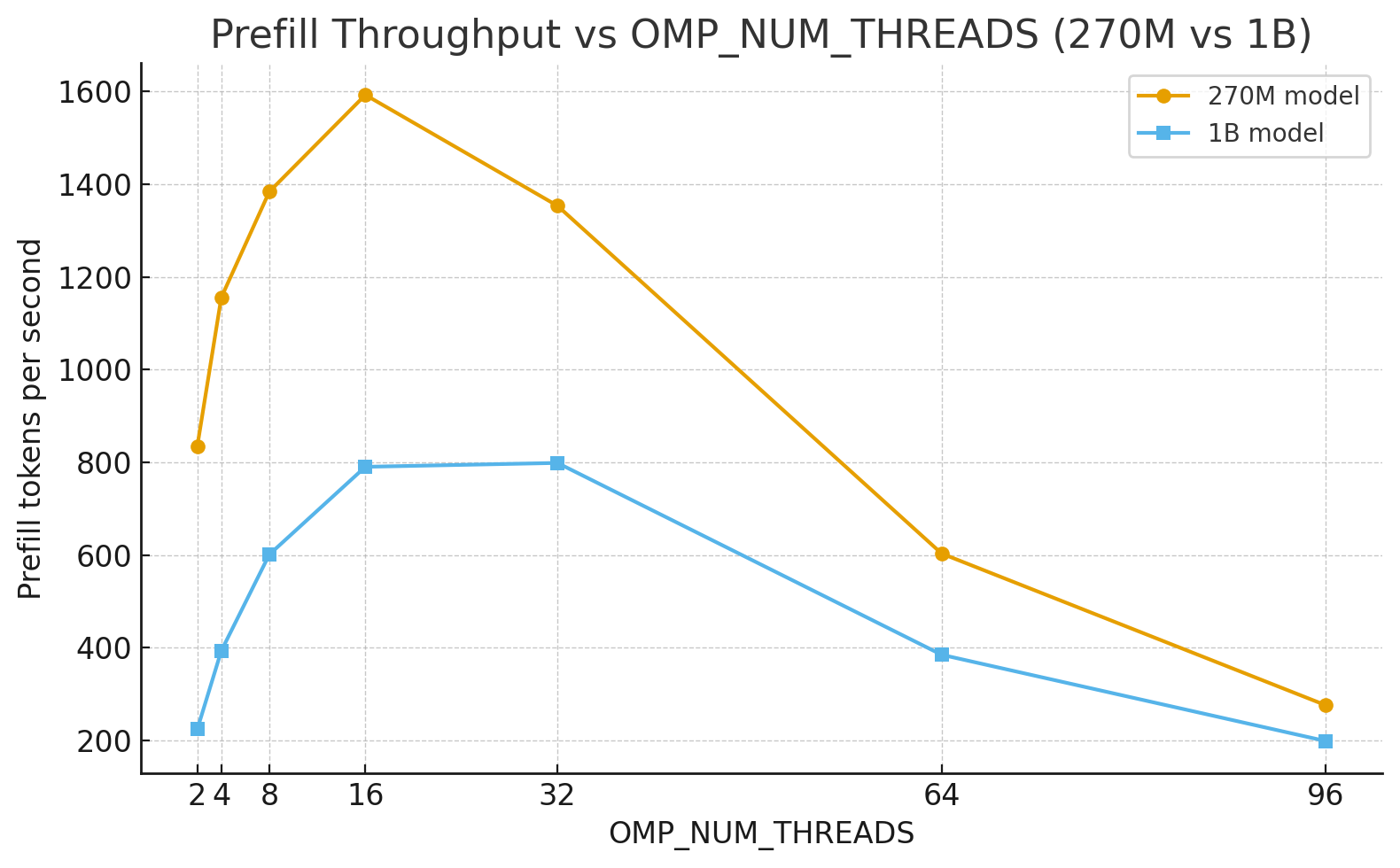

The graph below shows how prefill tokens per second change with the number of OpenMP threads for the 270M and 1B variants of Gemma-3:
Image Alt Text:Line graph comparing prefill throughput performance of Gemma-3 270M and 1B models across different thread counts from 2 to 96. The y-axis shows tokens per second (0-3000), and the x-axis shows number of OpenMP threads. Both lines peak at 16-32 threads, with the 270M model achieving higher throughput but showing a steeper decline after peak performance alt-txtPrefill throughput versus thread count for Gemma-3 models
As expected, the smaller 270M model runs faster. Both models reach their optimal token generation rate at around 16 to 32 threads, though the 270M model exhibits a sharper performance drop-off beyond this range compared with the 1B variant.
