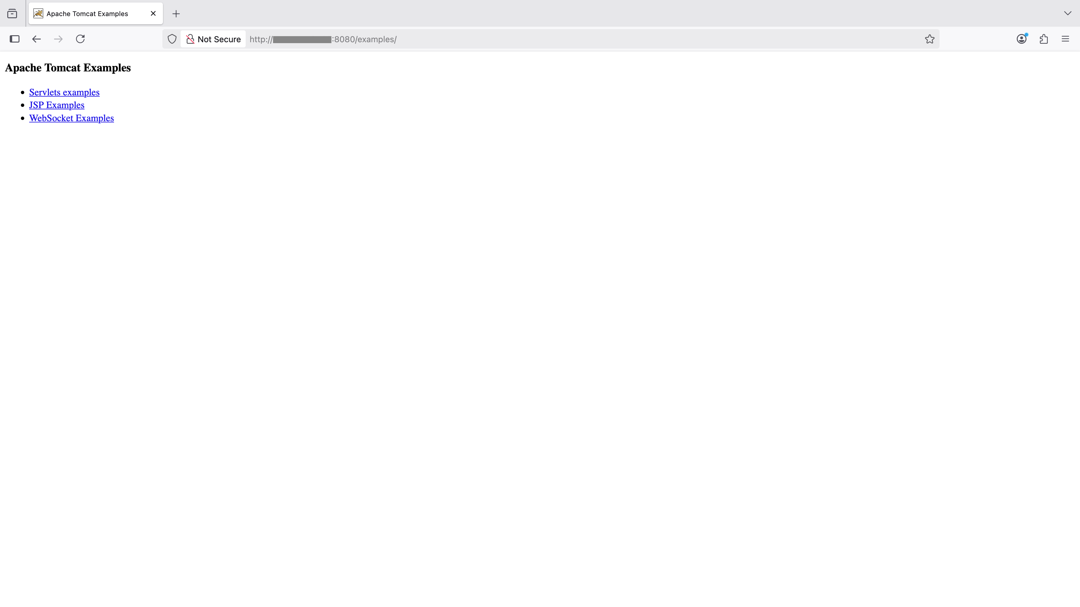

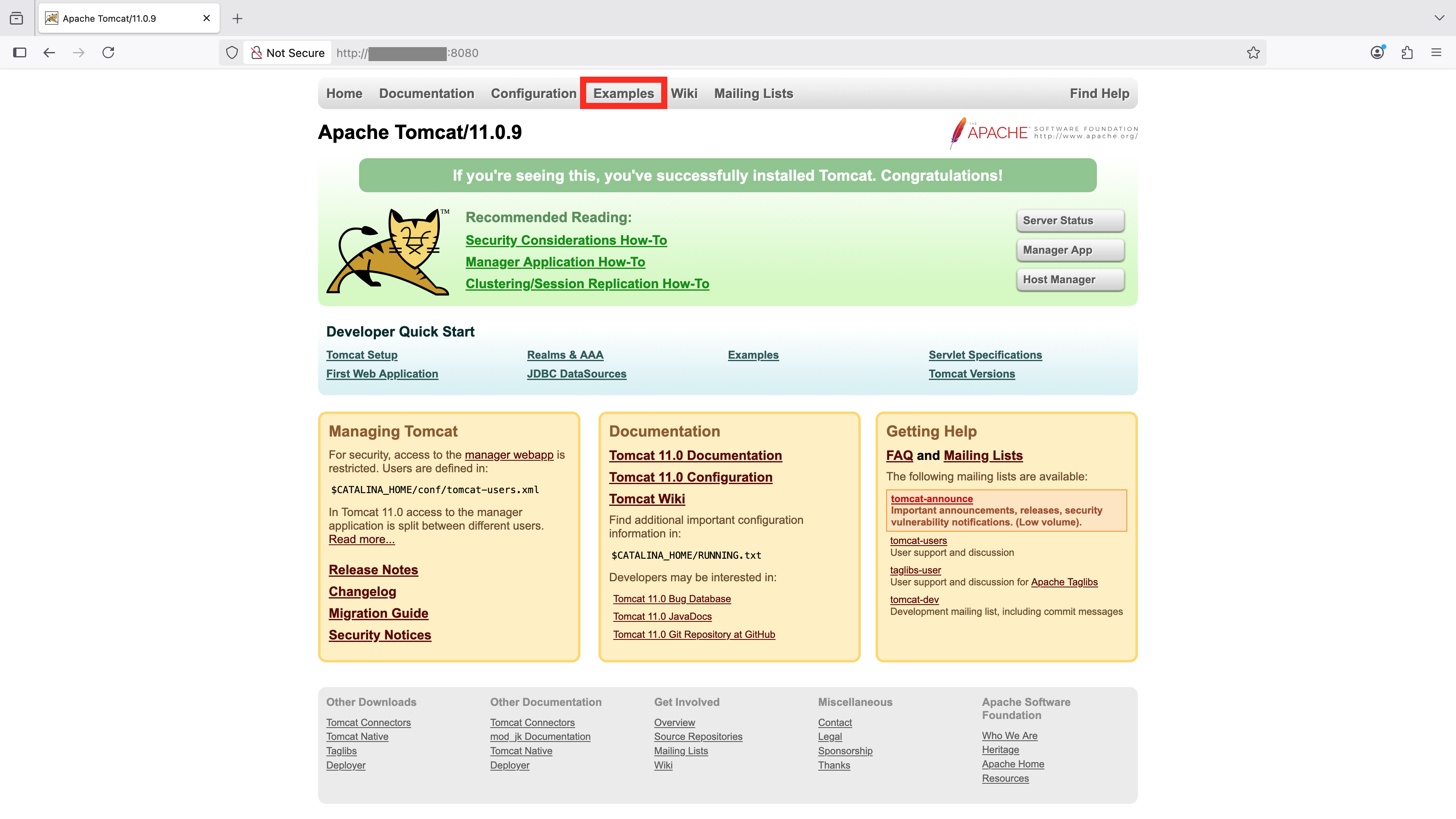

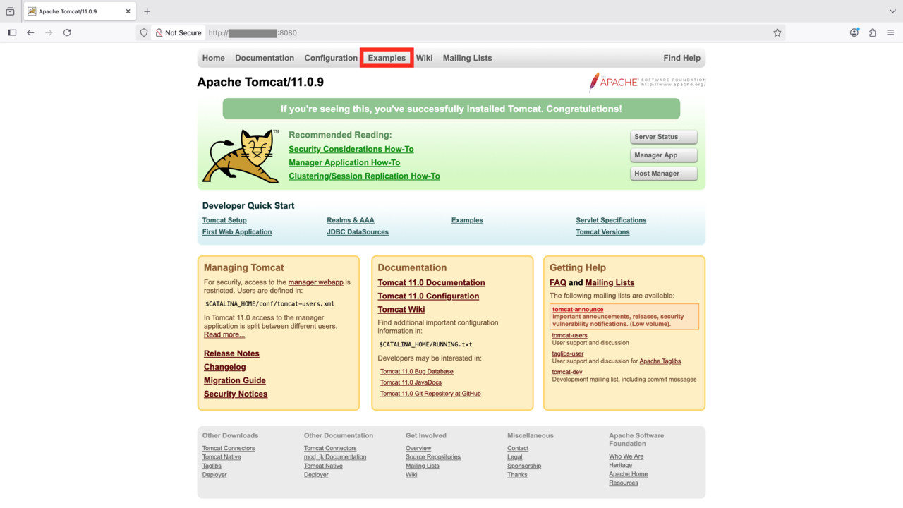

Replace ${tomcat_ip} with the public or private IP address of your Arm server and open:
http://${tomcat_ip}:8080/examples
You should see the Tomcat welcome page and examples, as shown below:
Apache Tomcat homepage
Apache Tomcat examples
Ensure port 8080 is open in the security group or firewall for your Arm‑based Linux machine.
