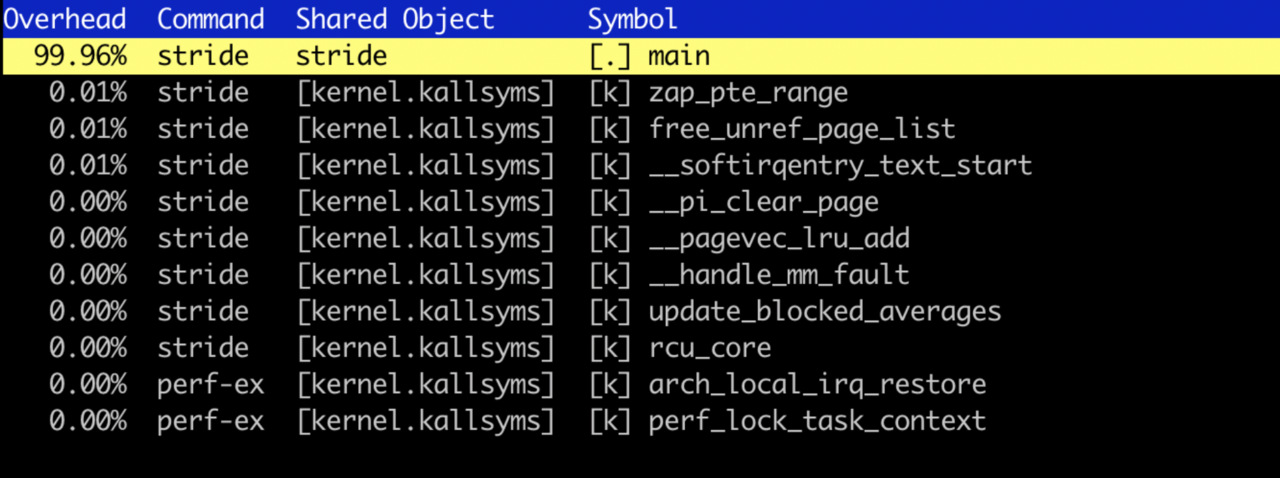

To view the recorded data use `perf report`:
perf report
When the report opens, use the down arrow key to highlight the `main` function:
![Image Alt Text:stride](/learning-paths/servers-and-cloud-computing/top-down-n1/report-1.webp)

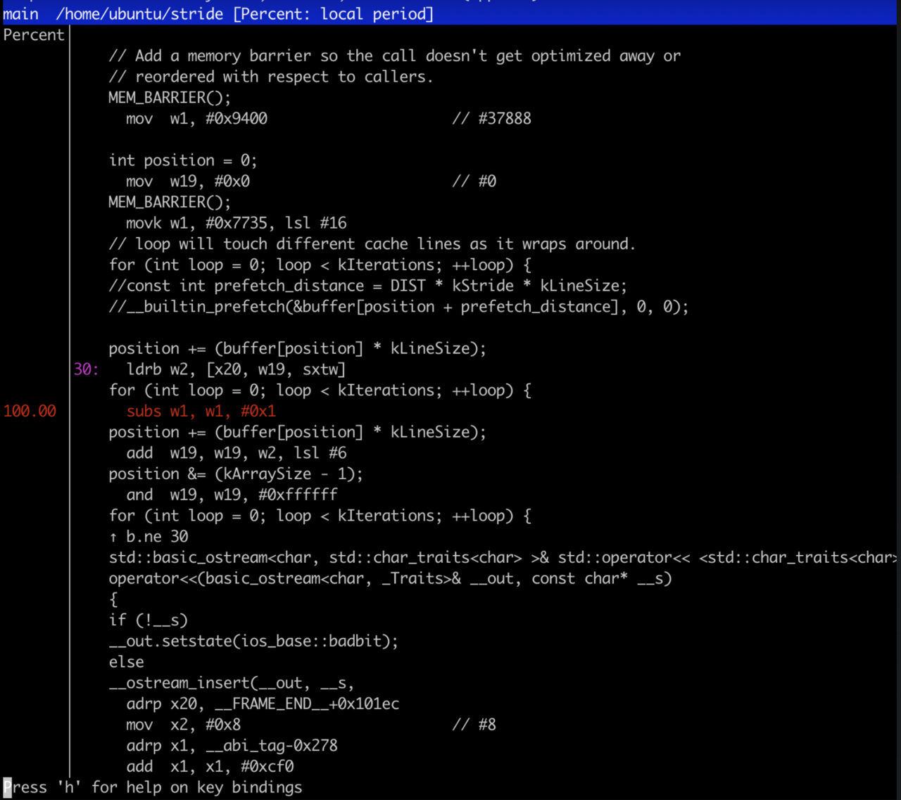

Press return to annotate the main function.
![Image Alt Text:annotate](/learning-paths/servers-and-cloud-computing/top-down-n1/report-2.png)

All the samples are on `subs` instruction which is right after the load instruction which reads the array and causes the high cache miss rate. Press the `q` key to exit the report.
