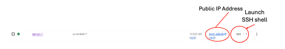

After the instance starts, select SSH next to the VM in the instance list to open a browser-based terminal session.
Image Alt Text:Google Cloud Console VM instances page displaying running instance with green checkmark and SSH button in the Connect column alt-txtConnecting to a running C4A VM using SSH
