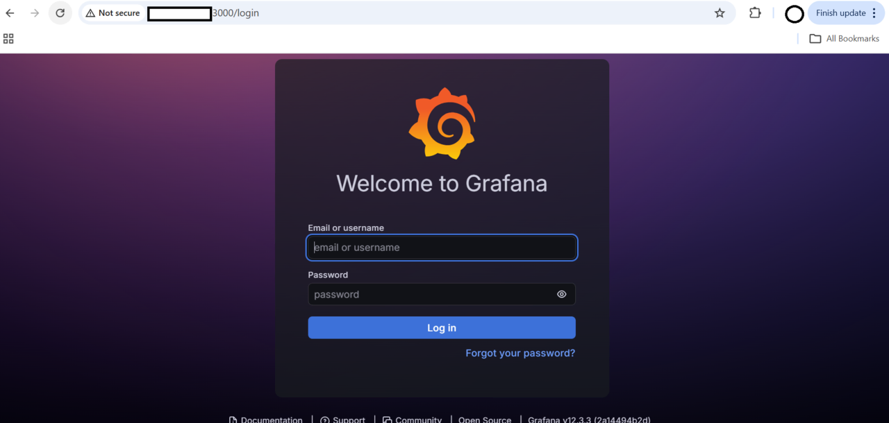

You will be prompted to change the password on first login. Provide and save off a new password. Re-login if needed using the new password:
Image Alt Text:Grafana login page showing username and password fields with a Sign In button alt-txtGrafana login page

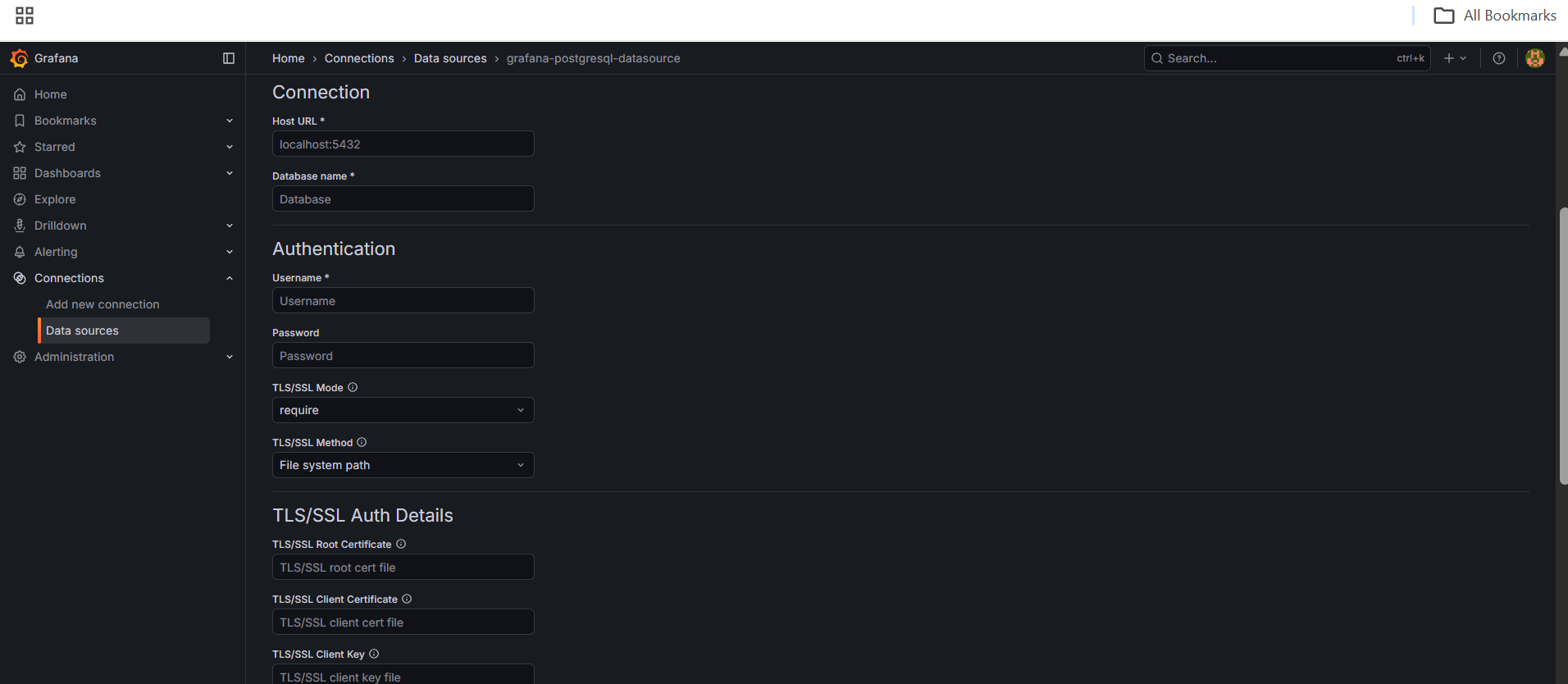

Step 3: Configure connection settings
Fill the form exactly as below:
FieldValue
Host URLlocalhost:5432
Database namesensors
Usernamepostgres
Password<postgres password saved>
TLS/SSL Modedisable
Image Alt Text:PostgreSQL data source connection settings alt-txtPostgreSQL data source settings
Scroll down and select Save & Test.
You should see “Database connection OK.”
Image Alt Text:Grafana PostgreSQL data source save and test success alt-txtGrafana PostgreSQL data source save and test
