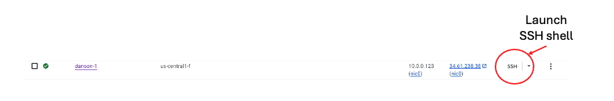

  • Once created, find your VM in the list and click SSH to open an SSH session in your browser.
Image Alt Text:Screenshot showing the SSH option next to a running VM instance in the Google Cloud Console. The SSH button is highlighted, indicating how to launch a secure shell session into the VM. alt-text Invoke an SSH session into your running VM instance
