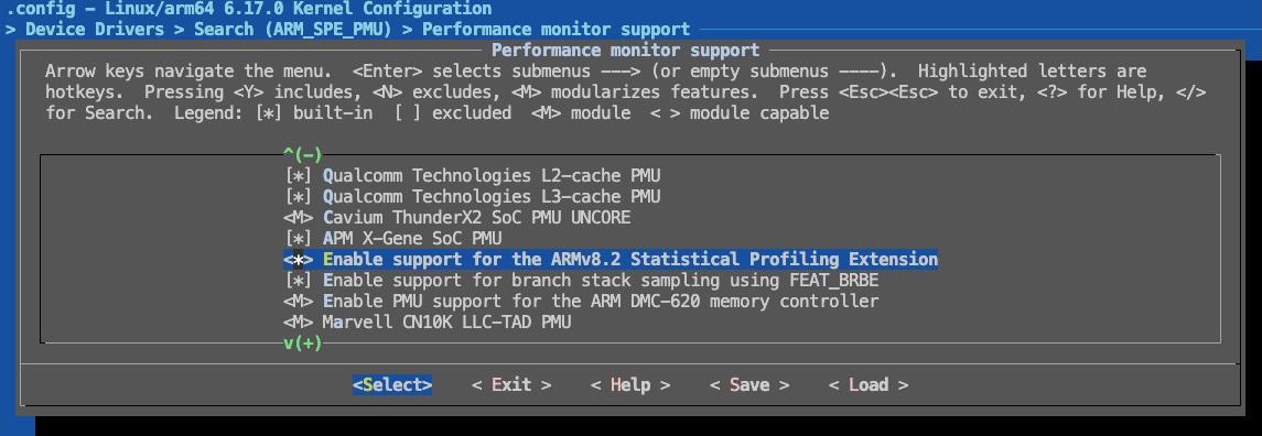

### Use the interactive configuration menu
Alternatively, you can enable the option using the interactive terminal UI from the root of the kernel directory:
make menuconfig
1. Press `/` to search.
2. Enter `ARM_SPE_PMU`. The `menuconfig` search also strips the `CONFIG_` prefix, so entering `ARM_SPE_PMU` is correct.
3. Select the option when it appears.
4. Press `y` to build it into the kernel (`=y`) or `m` to build it as a module (`=m`).
In most cases, building it into the kernel (`y`) is preferred for profiling.
![Kernel menuconfig with ARM_SPE_PMU enabled](https://learn.arm.com/learning-paths/servers-and-cloud-computing/spe-on-performix/enabled_support.png)
*Kernel menuconfig with ARM_SPE_PMU enabled*
