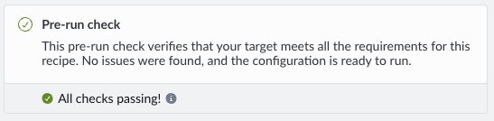

Return to Performix. The `Memory Access` recipe should now show `All checks passing!`.
![Arm Performix memory access recipe with all checks passing](https://learn.arm.com/learning-paths/servers-and-cloud-computing/spe-on-performix/memory-access-passing.png)
*Arm Performix memory access recipe with all checks passing*

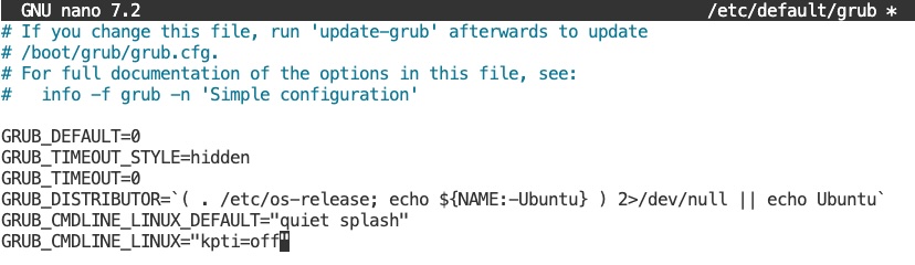

Use your preferred editor to update `GRUB_CMDLINE_LINUX` in `/etc/default/grub` and add `kpti=off`, as shown in the following screenshot.
![GRUB_CMDLINE_LINUX set to kpti=off in /etc/default/grub](https://learn.arm.com/learning-paths/servers-and-cloud-computing/spe-on-performix/grub_config_change.png)
*GRUB_CMDLINE_LINUX set to kpti=off in /etc/default/grub*
> Disabling KPTI has security implications. You should do so only on trusted systems.
Run the following commands to update the GRUB configuration and reboot. `update-grub` regenerates the bootloader configuration from `/etc/default/grub`. Ensure it completes without errors before rebooting.
