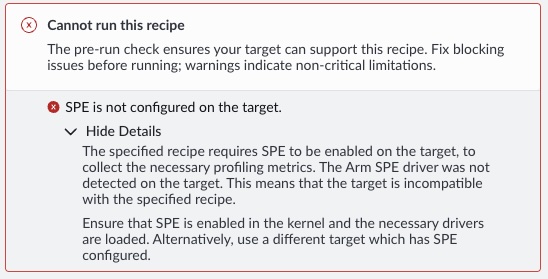

Connect to your instance, select the Recipes tab, and then select the Memory Access recipe. Performix automatically runs a precheck and prints the status at the end of the page. If you receive the SPE is not configured status shown in the following screenshot, you need to enable SPE before you can run the recipe.
Image Alt Text:Screenshot of the Arm Performix Memory Access recipe showing a red status notification at the bottom of the page indicating that SPE has not been configured for the target system. This is the expected message when the arm_spe_pmu driver is missing or not loaded.Arm Performix Memory Access recipe reporting that SPE is not configured
If you receive a different error message, SPE might not be the cause of your issue. For more information, see the Performix user guide .
