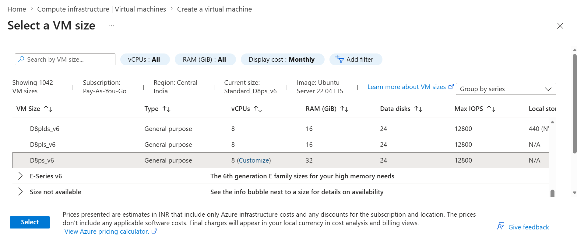

  5. In the Size field, select See all sizes and select the D-Series v6 family of virtual machines.
  6. Select D8ps_v6 from the list as shown in the following diagram:
Image Alt Text:Azure Portal showing D-Series v6 VM size selection with D8ps_v6 highlightedSelect D8ps_v6 from the D-Series v6 family

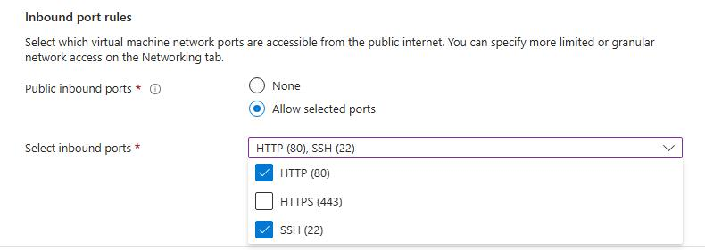

  2. In the Inbound port rules, select HTTP (80) and SSH (22) as the inbound ports, as shown in the following screenshot:
Image Alt Text:Azure Portal showing inbound port rules with HTTP (80) and SSH (22) selectedConfigure inbound port rules for HTTP and SSH access

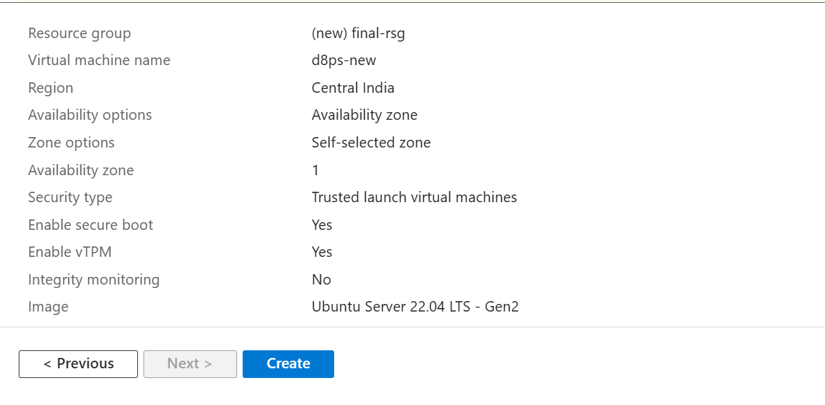

  1. Select the Review + Create tab and review the configuration for your virtual machine. It should look like the following:
Image Alt Text:Azure Portal Review + Create tab showing VM configuration summary ready for deploymentReview VM configuration before creation

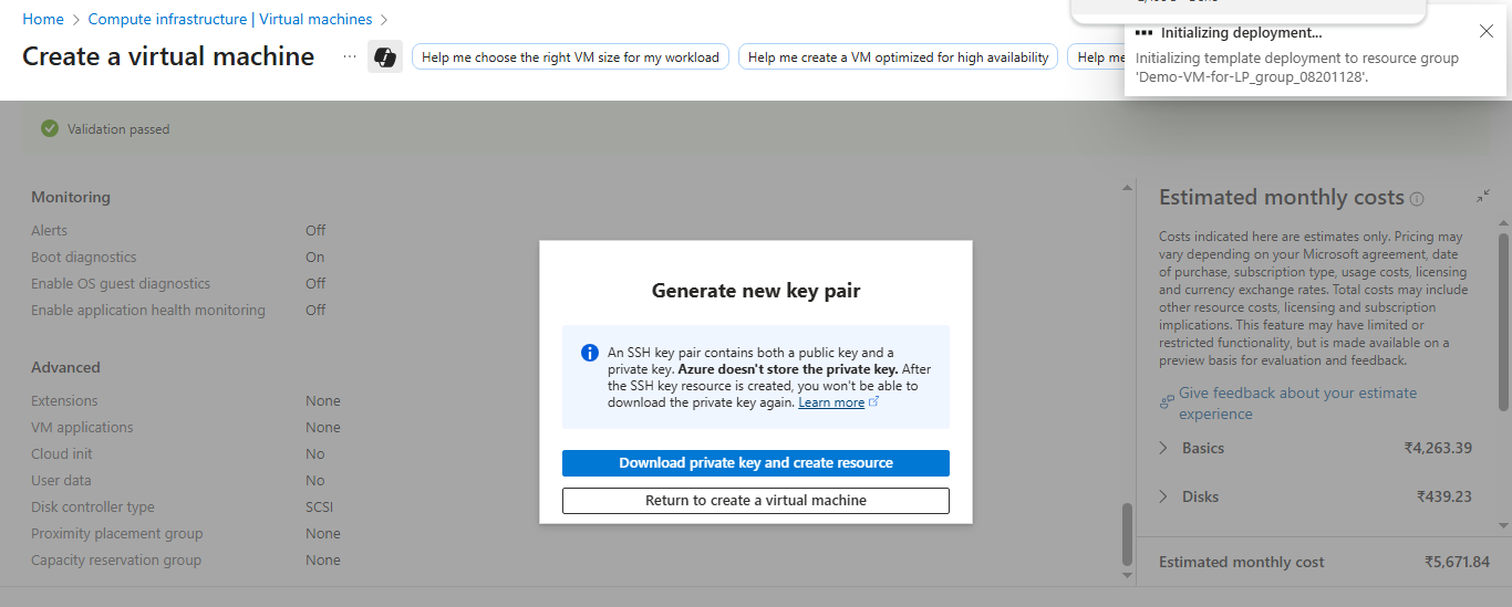

  1. After reviewing the configuration, select the Create button and then the Download Private key and Create Resource button.
Image Alt Text:Azure Portal showing Create button and SSH key download dialogDownload SSH key and create the virtual machine

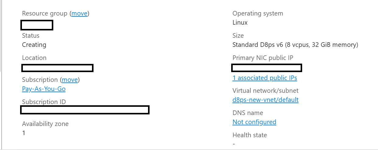

Your virtual machine should be ready and running in a few minutes. You can SSH into the virtual machine using the private key, along with the public IP details.
Image Alt Text:Azure Portal showing successful VM deployment with confirmation detailsSuccessful VM deployment confirmation
You’ve now successfully created an Azure Cobalt 100 Arm64 virtual machine running Ubuntu 22.04 LTS Server with SSH authentication configured. The VM is now fully prepared for running distributed data processing workloads.
