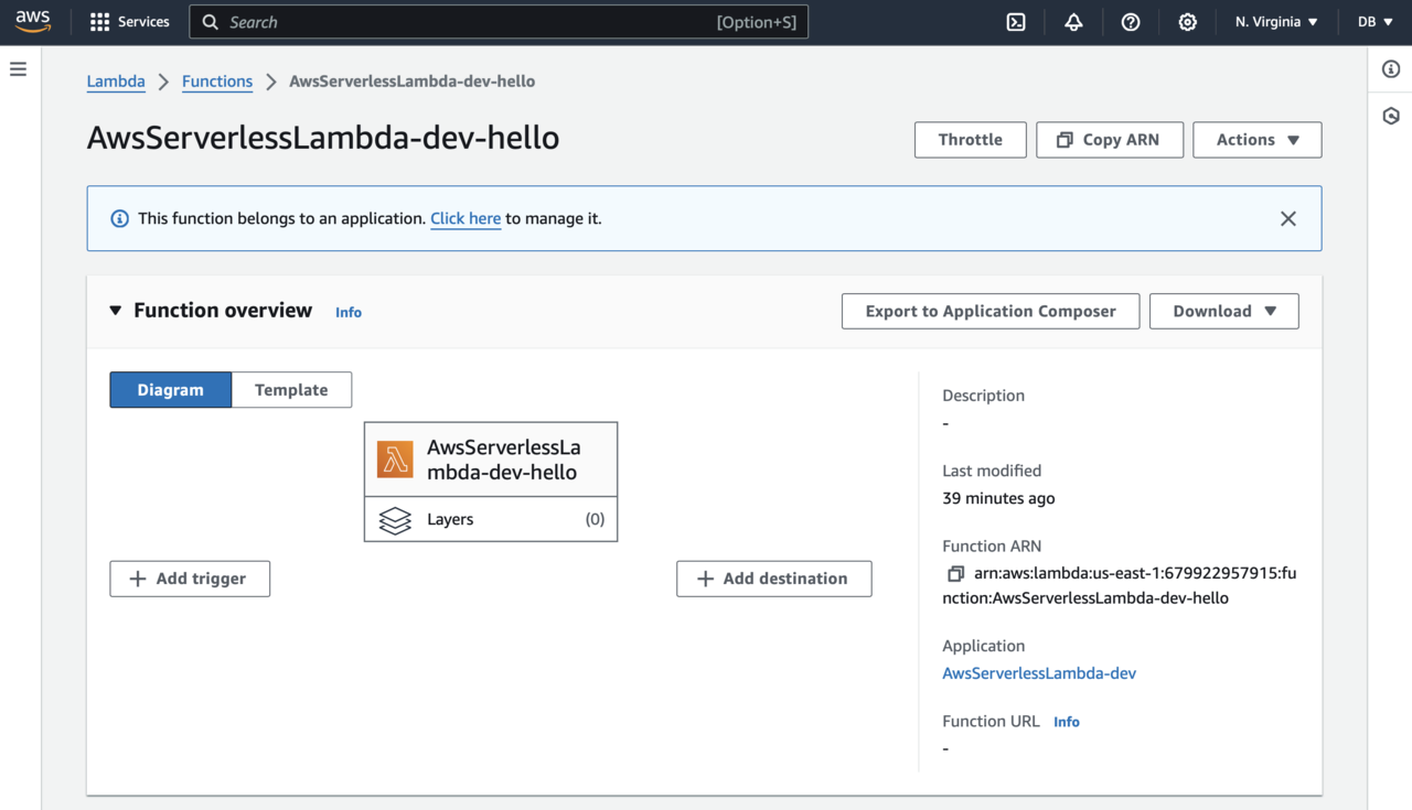

Finally, log into the AWS console. Change the region to us-east-1 (N. Virginia). Then, go to the Lambda dashboard to see the deployed Lambda function. It will be named AwsServerlessLambda-dev-hello:
Image Alt Text:fig1
