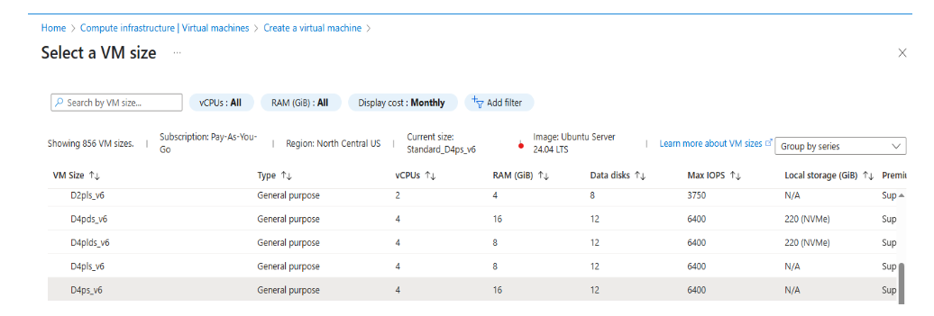

  • In the Size field, select See all sizes and select the D-Series v6 family of virtual machines.
  • Select D4ps_v6 from the list as shown in the diagram below:
Image Alt Text:Azure Portal showing D-Series v6 VM size selection with D4ps_v6 highlightedSelect D4ps_v6 from the D-Series v6 family

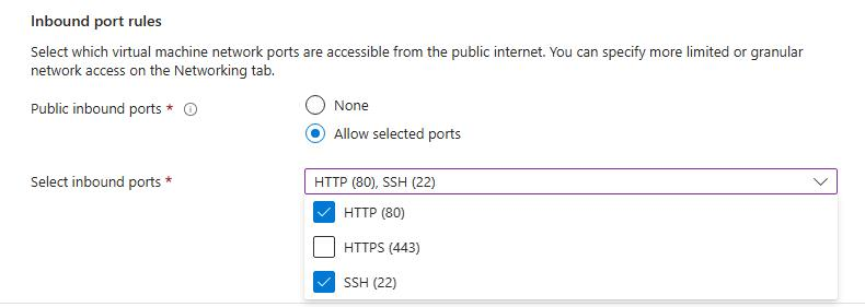

  • In the Inbound port rules, select HTTP (80) and SSH (22) as the inbound ports, as shown below:
Image Alt Text:Azure Portal showing inbound port rules with HTTP (80) and SSH (22) selectedConfigure inbound port rules for HTTP and SSH access

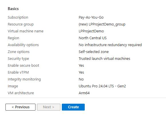

  • Now select the Review + Create tab and review the configuration for your virtual machine. It should look like the following:
Image Alt Text:Azure Portal Review + Create tab showing VM configuration summary ready for deploymentReview VM configuration before creation

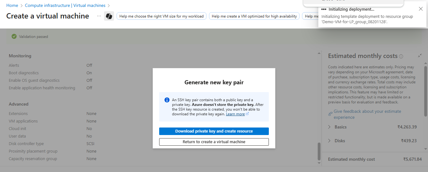

  • When you’re happy with your selection, select the Create button and then Download Private key and Create Resource button.
Image Alt Text:Azure Portal showing Create button and SSH key download dialogDownload SSH key and create the virtual machine

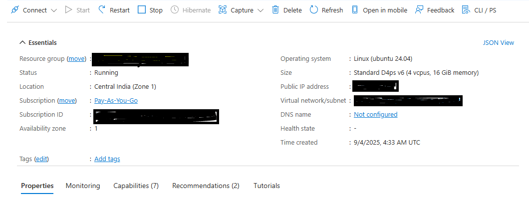

Your virtual machine should be ready and running in a few minutes. You can SSH into the virtual machine using the private key, along with the public IP details.
Image Alt Text:Azure Portal showing successful VM deployment with confirmation detailsSuccessful VM deployment confirmation
