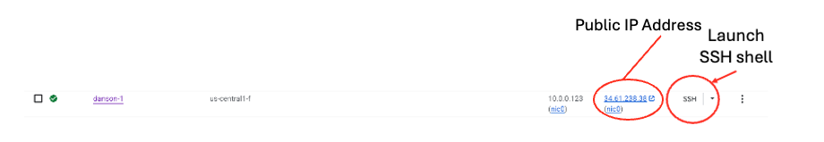

After the instance starts, select SSH next to the VM in the instance list to open a browser-based terminal session.
Image Alt Text:Google Cloud Console VM instances page showing the running C4A instance with a green status checkmark and the SSH button highlighted in the Connect columnConnecting to a running C4A VM using SSH
