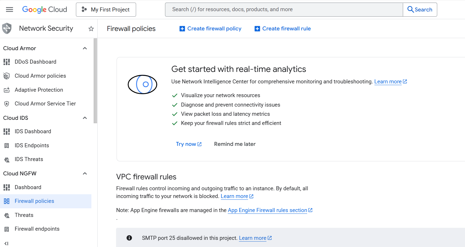

Navigate to the Google Cloud Console , go to VPC Network > Firewall, and select Create firewall rule.
Image Alt Text:Google Cloud Console VPC Network Firewall page showing the Create firewall rule button in the top menu barCreate a firewall rule in Google Cloud Console

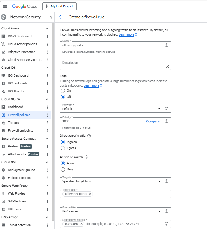

Set the Name of the new rule to “allow-ray-ports”. Select your network that you intend to bind to your VM.
Set Direction of traffic to “Ingress”. Set Allow on match to “Allow” and Targets to “Specified target tags”. Enter “allow-ray-ports” in the Target tags text field. Set Source IPv4 ranges to “0.0.0.0/0”.
Image Alt Text:Google Cloud Console Create firewall rule form with Name set to allow-ray-ports and Direction of traffic set to IngressConfiguring the allow-ray-ports firewall rule

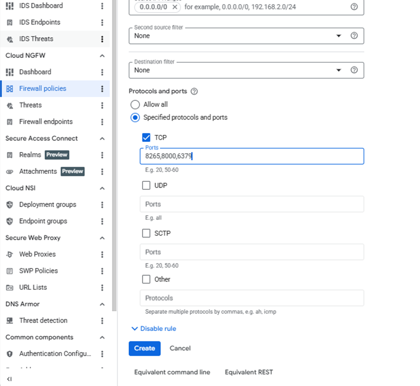

Finally, select Specified protocols and ports under the Protocols and ports section. Select the TCP checkbox and enter:
8265,8000,6379
  • 8265 → Ray Dashboard
  • 8000 → Ray Serve API
  • 6379 → Ray Head Node
Then select Create.
Image Alt Text:Google Cloud Console Protocols and ports section showing TCP checkbox selected with ports 8265, 8000, and 6379 configured for Ray Dashboard, Serve API, and Head NodeSetting Ray ports in the firewall rule
