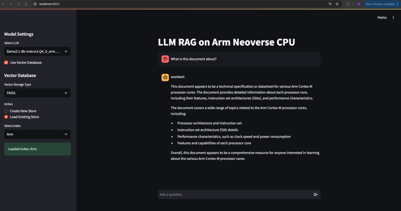

Load Existing Store
After creating the index, you can switch to the Load Existing Store option and then select the index you created earlier. Initially, it will be the only available index and will be auto-selected.
Follow these steps:
  1. Switch to the Load Existing Store option in the sidebar.
  2. Select the index you created. It should be auto-selected if it is the only one available.
This allows you to use the uploaded document for generating contextually-relevant responses. Refer to the image below for guidance:
Image Alt Text:RAG_IMG2
Interact with the LLM
You can now start issuing various queries to the LLM using the prompt in the web application. The responses will be streamed both to the frontend and the backend server terminal.
Follow these steps:
  1. Enter your query in the prompt field of the web application.
  2. Submit the query to receive a response from the LLM.
Image Alt Text:RAG_IMG3
