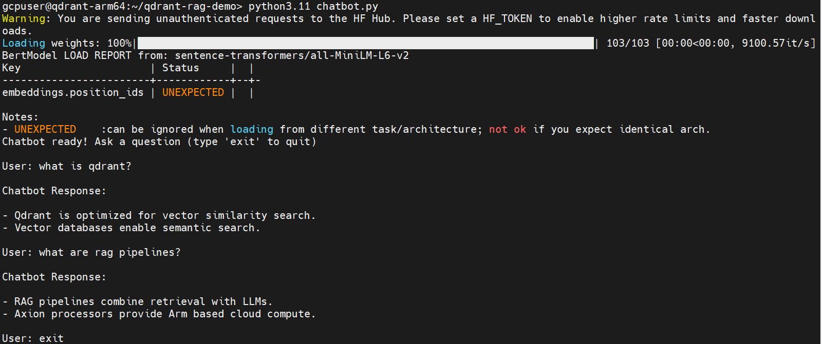

Example chatbot interaction
The following image shows the chatbot running on the Axion VM and retrieving relevant results from the Qdrant vector database.
Image Alt Text:Qdrant chatbot terminal showing user questions and semantic search responses retrieved from the Qdrant vector database on AxionQdrant chatbot semantic search demo on Axion
How the chatbot works
  1. The user asks a question.
  2. The system converts the question into a vector embedding.
  3. Qdrant performs a similarity search.
  4. The chatbot returns the most relevant knowledge documents.
  5. This enables semantic search instead of simple keyword matching.
