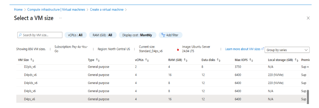

  • In the Size field, select See all sizes and select the D-Series v6 family of virtual machines.
  • Select D4ps_v6 from the list as shown in the diagram below:
Image Alt Text:Azure Portal VM size selection showing the D-Series v6 (Dpsv6) family highlighted with D4ps_v6 option selected for Arm64 architectureSelect D4ps_v6 from the D-Series v6 family

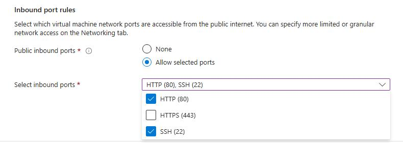

  • In the Inbound port rules, select HTTP (80) and SSH (22) as the inbound ports, as shown below:
Image Alt Text:Azure Portal inbound port rules configuration showing HTTP (80) and SSH (22) selected as allowed incoming trafficConfigure inbound port rules for HTTP and SSH access

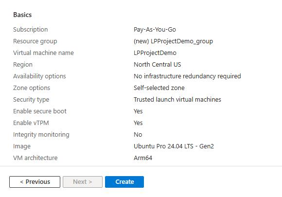

  • Now select the Review + Create tab and review the configuration for your virtual machine. It should look like the following:
Image Alt Text:Azure Portal Review + Create tab showing VM configuration summary with Ubuntu Pro 24.04 LTS image, D4ps_v6 size, and networking settings configuredReview VM configuration before creation

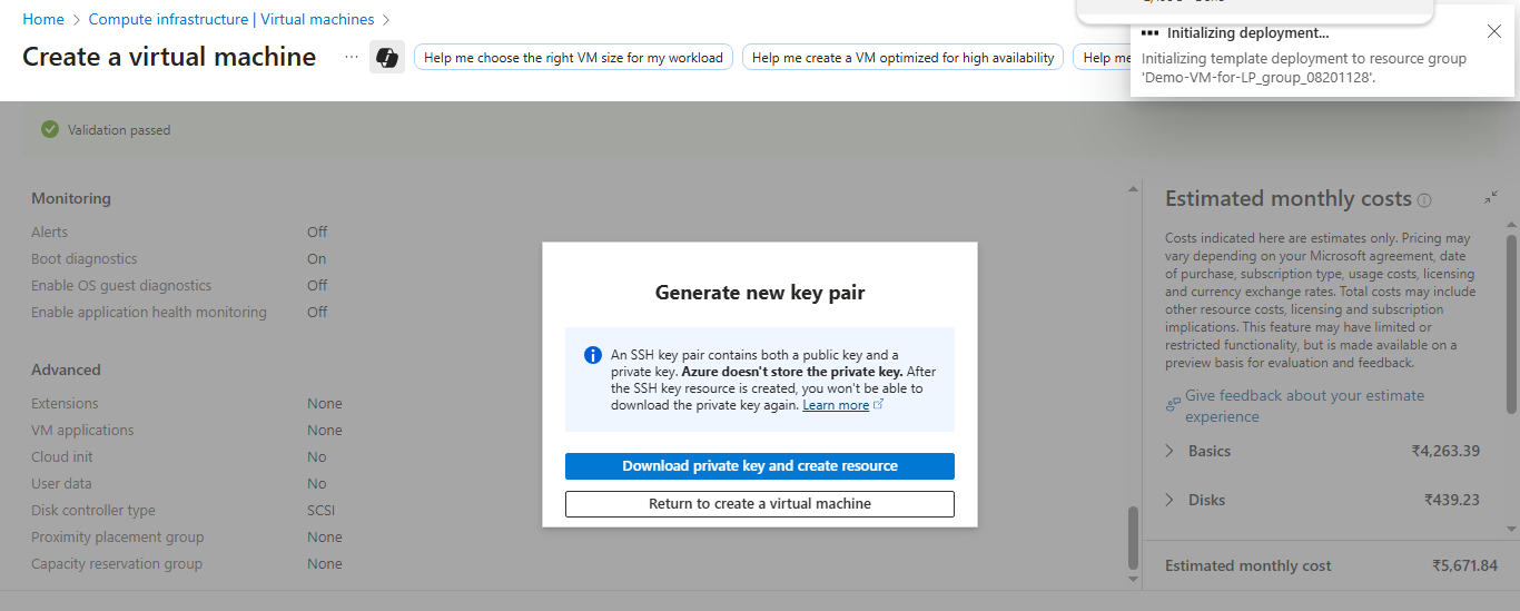

  • When you are happy with your selection, select the Create button and then Download Private key and Create Resource button.
Image Alt Text:Azure Portal showing the Create button and Download Private key and Create Resource button to finalize VM creationDownload SSH key and create the virtual machine

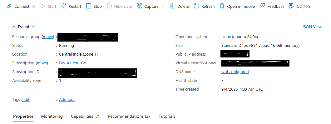

Your virtual machine should be ready and running in a few minutes. You can SSH into the virtual machine using the private key, along with the public IP details.
Image Alt Text:Azure Portal showing successful VM deployment with green checkmark, VM name, resource group, and public IP address displayed in the confirmation notificationSuccessful VM deployment confirmation
