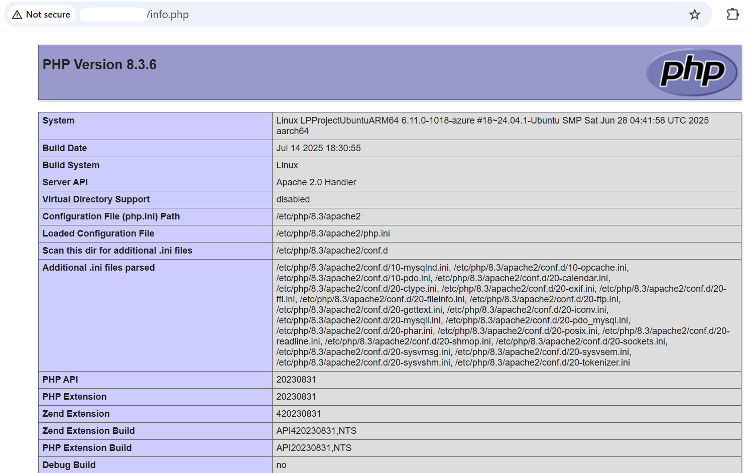

Verify PHP from your browser
Now, verify that your PHP setup works correctly from outside the VM. Open a web browser on your local machine (such as Chrome, Firefox, or Edge) and enter the following URL in the address bar:
http://<YOUR_VM_PUBLIC_IP>/info.php
Replace <YOUR_VM_PUBLIC_IP> with the public IP of your Google Cloud Axion C4A Arm VM.
If your configuration is correct, your browser displays the PHP Info page. This page shows detailed information about your PHP environment, including version, build options, and loaded modules, as shown below:
Image Alt Text:Screenshot of PHP info page in browser showing PHP configuration details on Google Cloud Axion C4A Arm VM. alt-textPHP info page in browser on Google Cloud Axion C4A Arm VM
Successfully loading the PHP Info page in your browser confirms that your PHP and Apache environment on Google Cloud Axion C4A Arm is configured and functioning properly.
