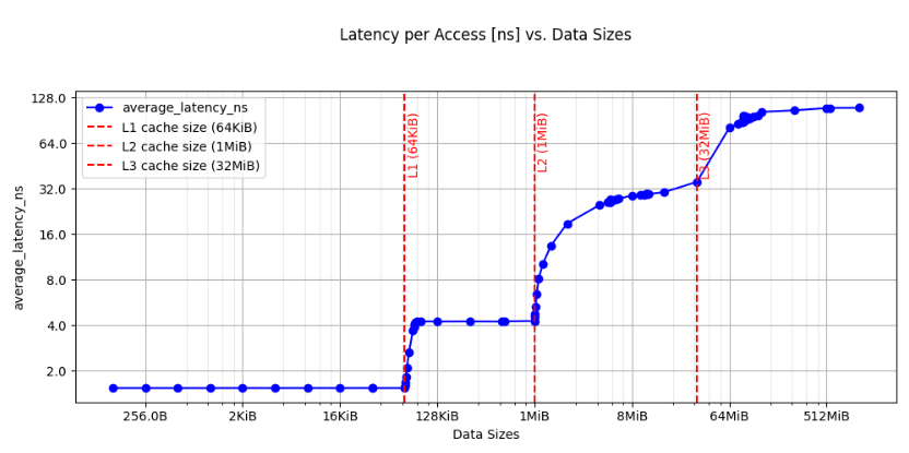

The System Characterization recipe runs a set of low-level benchmarks, diagnostic scripts, and system tests to analyze performance on Arm-based platforms. It evaluates key hardware characteristics, including memory latency and bandwidth, helping you gather early, repeatable insight into performance-critical subsystems. The recipe is especially useful for platform bring-up, system tuning, and architectural comparisons.
The following latency sweep plot shows one of the benchmarks that System Characterization provides: the average latency of memory accesses across varying working-set sizes. This benchmark reveals the latency of each cache level in the memory hierarchy.
![Latency sweep showing cache hierarchy transitions](https://learn.arm.com/learning-paths/servers-and-cloud-computing/performix-system-characterization/latency-sweep-plot.webp)
*Latency sweep showing cache hierarchy transitions*
