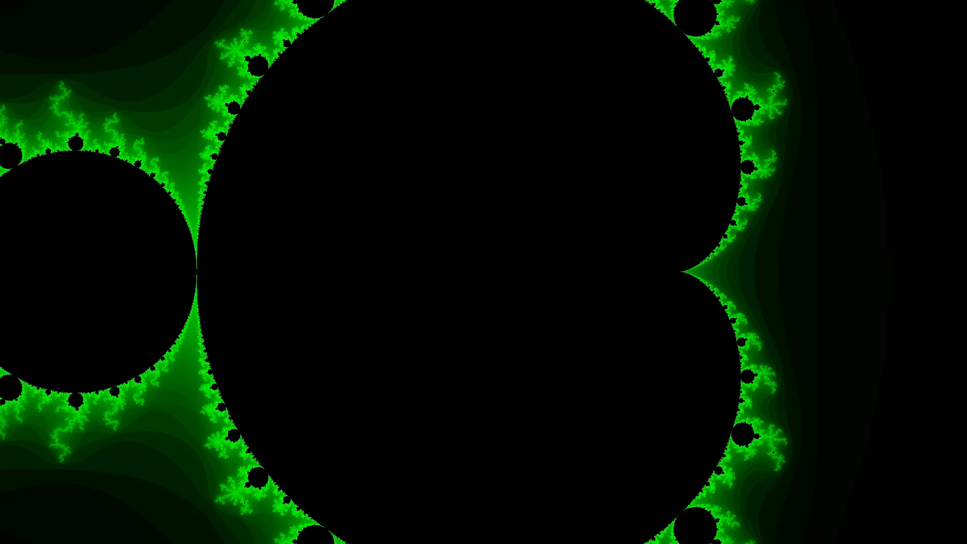

The application requires one argument: the number of threads to use. Run this new executable with 4 threads:
./builds/mandelbrot-baseline 4
The application generates a bitmap image file in your ./images directory that looks similar to the following fractal:
Image Alt Text:Mandelbrot set fractal generated by the sample applicationMandelbrot Set
