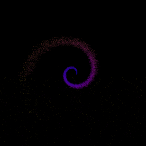

## Set up a Python virtual environment and run visualization
After building the application, from the repository root, run:
cd ..
python3 -m venv venv
source venv/bin/activate
pip install --upgrade pip
pip install -r scripts/requirements.txt
Generate simulation frames and create the GIF:
cd build
./baseline --visualize
python3 ../scripts/visualize.py galaxy_baseline.bin
The script reads simulation data from `galaxy_baseline.bin` and writes a GIF file `assets/galaxy_baseline.gif`.
![Orbiting galaxies workload visualization](https://learn.arm.com/learning-paths/servers-and-cloud-computing/performix-memory-access/galaxy_compressed.gif)
Use `--visualize` only for understanding the workload behavior. Don’t include visualization mode in profiling runs because file I/O alters the measured runtime characteristics.
