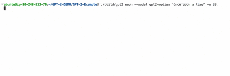

Run the `gpt2_neon` binary with the following command to observe the speedup.
./build/gpt2_neon --model gpt2-medium "Once upon a time" -n 20
![GPT-2 Neon runtime output on Arm Linux](https://learn.arm.com/learning-paths/servers-and-cloud-computing/performix-instruction-mix/gpt_neon.gif)
*GPT-2 Neon runtime output on Arm Linux*
The Neon implementation delivers a noticeable increase in token generation throughput. To evaluate the SVE implementation, run the same workload using the `gpt2_sve` binary instead of `gpt2_neon`. Performance gains will vary across systems, largely depending on the Scalable Vector Length (SVL) supported by the Arm Linux platform.

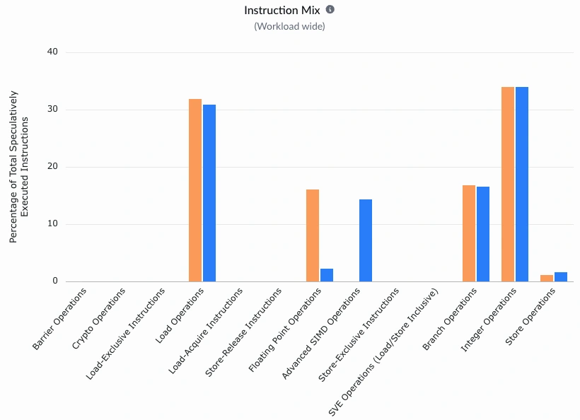

Rerun the Instruction Mix recipe with the `gpt2_neon` binary using the same recipe settings and workload arguments as baseline. After the run completes, select both runs and select **Compare** to open a comparison view.
> **Tip**
> Rename each run with a descriptive name, such as baseline and Neon, so you can identify and compare results quickly.
The baseline profile is mostly scalar instructions. After you add Neon intrinsics, the instruction mix shifts toward Advanced SIMD (Neon) instructions, showing that the code is using Arm Neon hardware more effectively.
![Neon versus scalar instruction mix](https://learn.arm.com/learning-paths/servers-and-cloud-computing/performix-instruction-mix/neon_scalar_instruction_mix.webp)

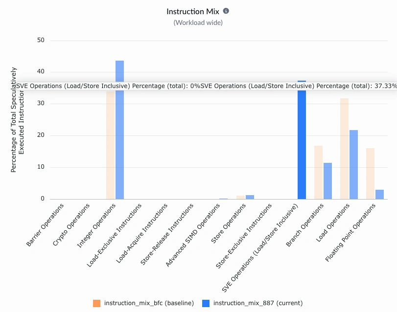

You can also compare SVE variants in the same way. The increase in SVE operations shows that this path is now using SVE hardware.
![SVE versus baseline instruction mix](https://learn.arm.com/learning-paths/servers-and-cloud-computing/performix-instruction-mix/sve_vs_baseline.webp)
