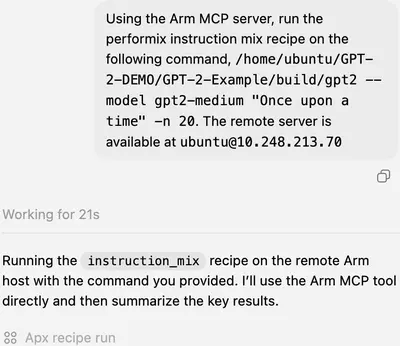

### Use the Arm MCP Server with Performix
You can also use an MCP-compatible coding assistant, such as GitHub Copilot or Codex, with the Arm MCP Server. This gives the assistant direct tool access to run Performix recipes on your remote Arm target and create a faster feedback loop while you iterate on `matmul_user`.
For setup details, see [Automate x86-to-Arm application migration using Arm MCP Server](https://learn.arm.com/learning-paths/servers-and-cloud-computing/arm-mcp-server/).
Install Docker if needed, then pull the MCP server image:
```bash
docker pull armlimited/arm-mcp:latest
To allow Performix access to remote targets from inside the container, mount your workspace plus SSH key and known hosts in your Codex MCP configuration (example `~/.codex/config.toml`):
```toml
[mcp_servers.arm-mcp]
command = "docker"
args = [
	"run",
	"--rm",
	"-i",
	"-v", "/path/to/your/workspace:/workspace",
	"-v", "/path/to/your/ssh/private_key:/run/keys/ssh-key.pem:ro",
	"-v", "/path/to/your/ssh/known_hosts:/run/keys/known_hosts:ro",
	"armlimited/arm-mcp"
Restart your coding assistant, then prompt it to run Performix Instruction Mix and Code Hotspots on your `gpt2_user` binary and suggest Arm intrinsics improvements.
![Coding assistant prompt for Performix analysis through Arm MCP Server](https://learn.arm.com/learning-paths/servers-and-cloud-computing/performix-instruction-mix/./mcp-performix-prompt.webp "Coding assistant prompt for Performix analysis through Arm MCP Server")
