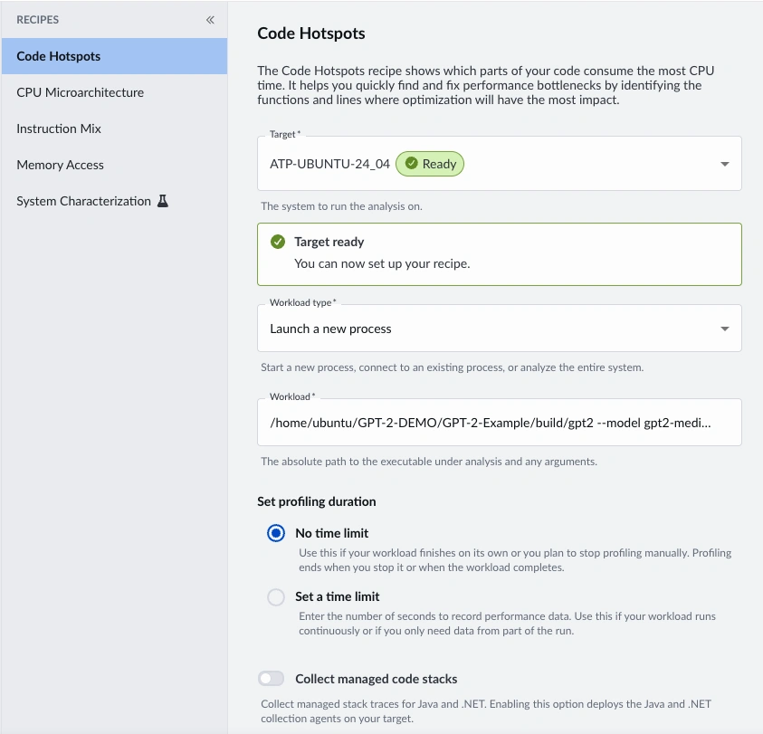

Open Arm Performix and select the **Code Hotspots** recipe. If this is your first run on the target, complete tool deployment as prompted.
Set the launch command to your baseline binary with the number of tokens (`-n`) set to `150`. This value keeps startup overhead small compared to inference time, so the profile minimizes the time taken to load the model weights.
Copy and paste the following command as the Performix Workload. If your path is different, adjust it to point to `gpt2`:
/home/ubuntu/GPT-2-Example/build/gpt2 --model gpt2-medium "Once upon a time" -n  150
![Code Hotspots recipe configuration for GPT-2 baseline](https://learn.arm.com/learning-paths/servers-and-cloud-computing/performix-instruction-mix/./code_hotspot.webp)
*Code Hotspots recipe configuration for GPT-2 baseline*

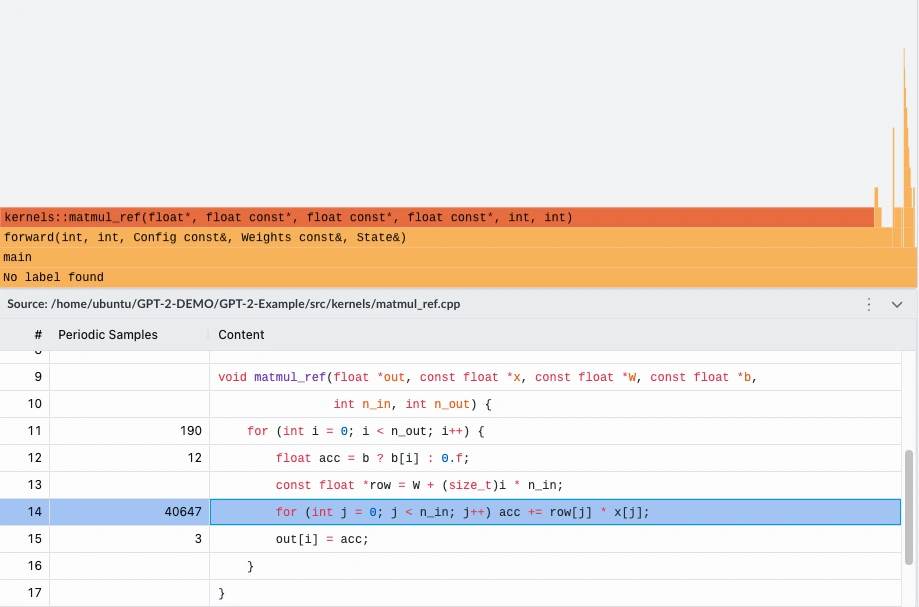

The results show that `kernels::matmul_ref()` is the hottest function. Double-click on the function to see which lines of source code are mostly attributed to the accumulate step of `kernels::matmul_ref()`.
![Hotspot results highlighting `matmul_ref`](https://learn.arm.com/learning-paths/servers-and-cloud-computing/performix-instruction-mix/./code_hotspot_results.webp)
*Hotspot results highlighting `matmul_ref`*
This confirms that matrix multiplication is the highest-impact optimization target.

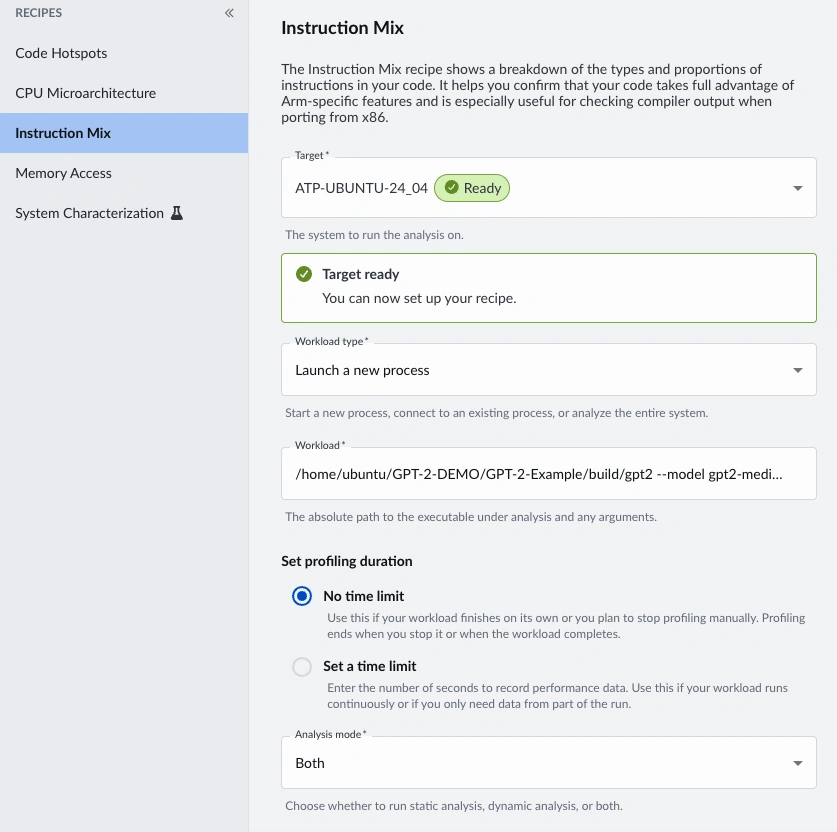

Open Arm Performix and select the **Instruction Mix** recipe.
Set the launch command to your baseline binary with the same runtime arguments used for baseline testing:
Note the number of counters.
Use the same model and prompt arguments as your baseline terminal run so the measurements are comparable.

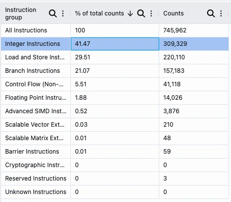

### Analyze static disassembly
After the run completes, review static disassembly first. This view is ordered by percentage contribution and provides a high-level profile of the application’s generated instruction stream. By reviewing static disassembly, you can identify broad characteristics, such as whether the code is branch-heavy, dominated by memory operations, or making effective use of SIMD instructions.
Use this static view to understand overall code generation patterns rather than to attribute performance to specific functions or source lines. Dynamic analysis is typically more relevant for optimization because it reflects the instructions that are actually executed at runtime.
![Static disassembly instruction classification](https://learn.arm.com/learning-paths/servers-and-cloud-computing/performix-instruction-mix/./static_disassembly.webp)
*Static disassembly instruction classification*

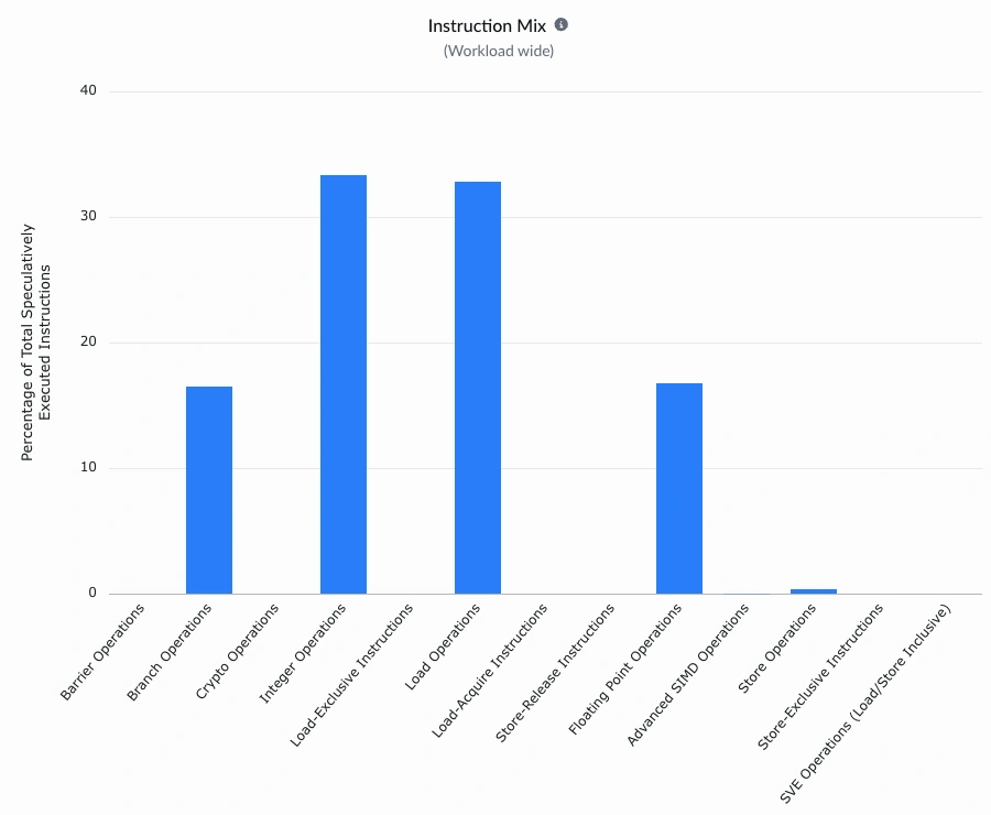

### Dynamic analysis
Then, inspect dynamic analysis bar chart to see where sampled runtime work is concentrated. Dynamic data is typically more useful for optimization because it reflects actual execution behavior for your input, runtime settings, and call frequencies.
![Dynamic function sample distribution](https://learn.arm.com/learning-paths/servers-and-cloud-computing/performix-instruction-mix/./instruction_mix_dynamic_analysis.webp)
*Dynamic function sample distribution*
Finally, in dynamic functions, you can break down operation types to individual functions. This is particularly useful when no single function dominates the profile, allowing you to inspect dynamic instruction patterns for specific functions.
