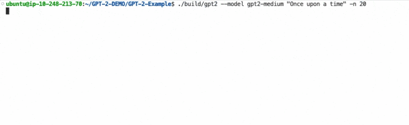

Run the scalar baseline binary:
```bash
./build/gpt2 --model gpt2-medium "Once upon a time" -n 20
The output is similar to:
![GPT-2 baseline runtime output on Arm Linux](https://learn.arm.com/learning-paths/servers-and-cloud-computing/performix-instruction-mix/gpt2-baseline.gif)
*GPT-2 baseline runtime output on Arm Linux*
