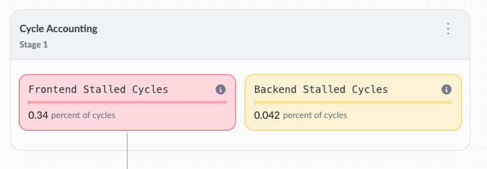

The analysis shows that the application is 0.34% frontend stalled compared to 0.042% backend stalled. The exact values depend on your hardware.
This difference between frontend and backend stalls means the CPU stalls while fetching or decoding instructions, even though backend resources are available. The CPU isn’t compute-bound. Instead, it’s waiting for instructions.

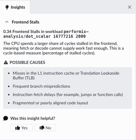

Performix provides guidance in the Insights panel to help you understand these results.
CPU Microarchitecture insights
You now know the application is frontend bound, but this is a tight loop with predictable control flow. Frontend stalls in this context often indicate that the CPU is processing too many instructions per unit of work.
