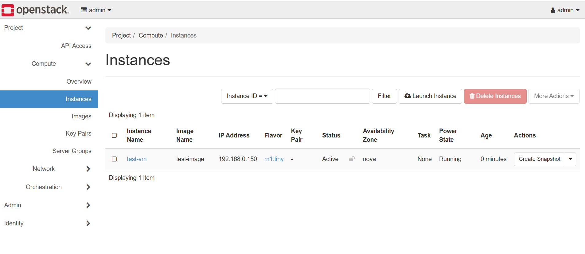

The following image shows a successfully launched instance in the OpenStack Horizon UI.
![OpenStack Horizon Instances view with running VM](https://learn.arm.com/learning-paths/servers-and-cloud-computing/openstack-on-azure/images/openstack-ui.png)
*OpenStack Horizon Instances view with running VM*
