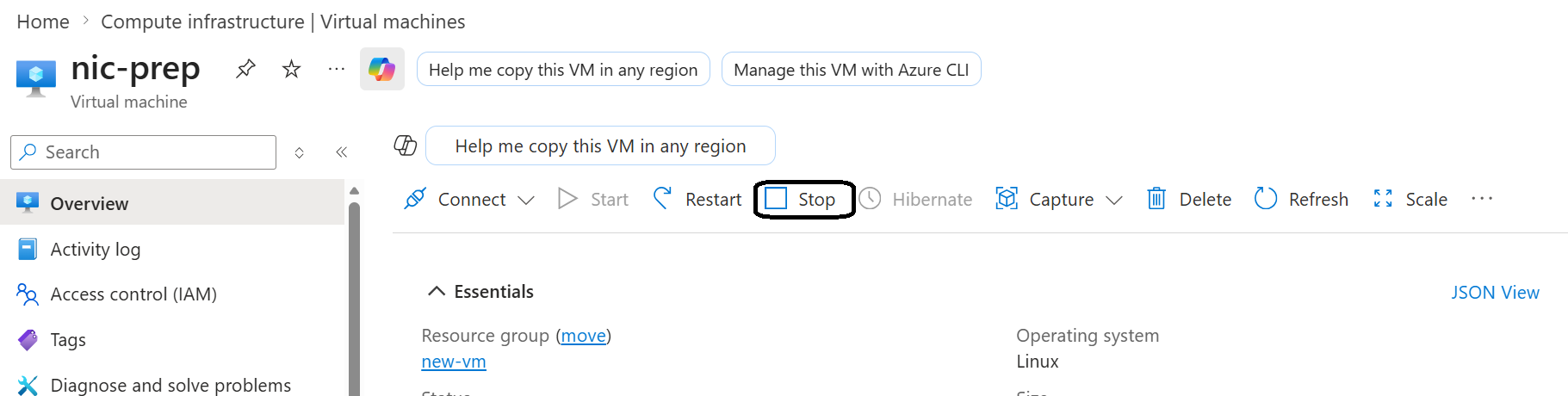

Stop the VM
Azure does not allow NIC attachment to a running VM. To add an NIC, you’ll need to first stop the VM.
Navigate to Virtual Machines, select your VM, and click Stop.
Stop the VM before attaching a network interface

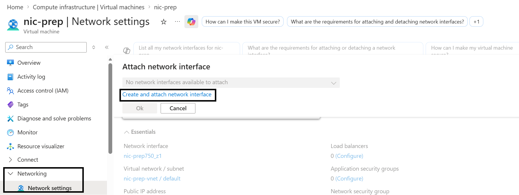

After stopping the VM, to attach a new NIC, follow these steps:
- In the Azure portal, navigate to Networking and then Network settings
- Click Attach network interface

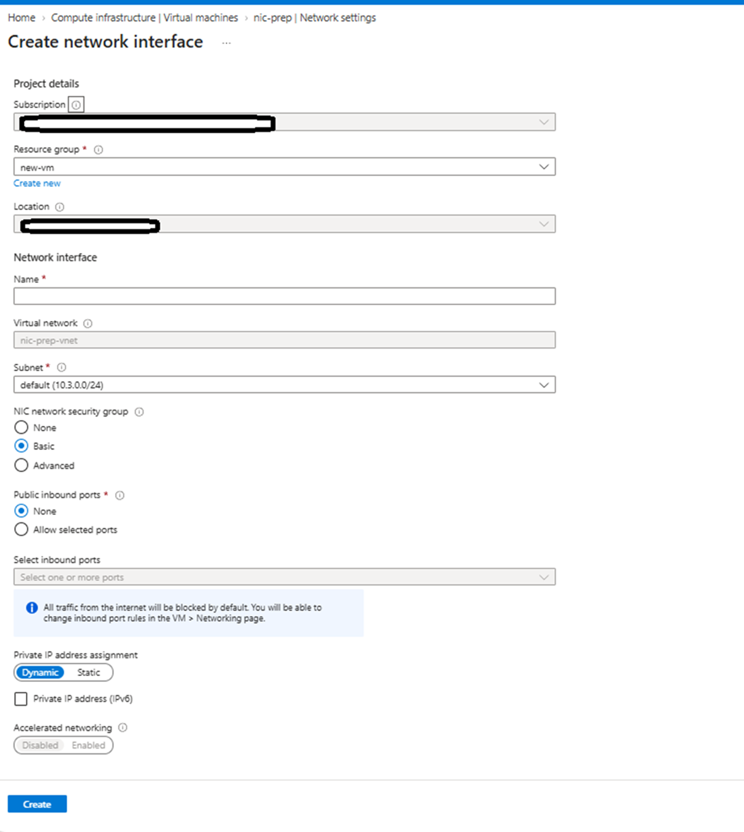

- Click Create new NIC
Create a new NIC for the OpenStack external network
- Enter a Name for the NIC
- For Virtual Network, keep the NIC in the same Virtual Network
- For Subnet, select the same subnet
- For Public inbound ports, select None
- Click Create
Attach network interface in Azure Networking settings

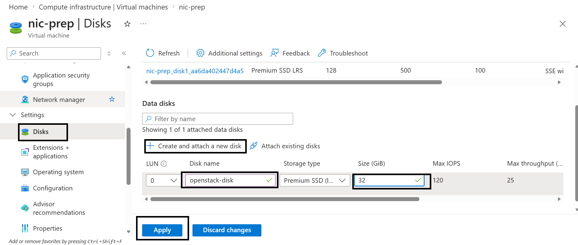

Create and attach a data disk in Azure
After restarting the VM, attach a data disk to it by following these steps:
- In the Azure Portal, navigate to Virtual Machines
- Click Disks
- Click Create and attach a new disk
- For Disk name, enter
openstack-disk - For Size, enter 32 GB, which is the recommended minimum
- For Storage type, select Standard SSD
- Click Apply
32 GB data disk attached for OpenStack storage
