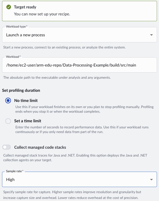

1. In the Arm Performix GUI, click **Recipes**. A **Code Hotspots** page opens.
   ![Image Alt Text:A screenshot of the Arm Performix GUI with the Code Hotspots recipe configuration for the baseline executable. The workload, profiling duration, and sample rate settings and their values are visible.](https://learn.arm.com/learning-paths/servers-and-cloud-computing/openrng-with-performix/run-code-hotspot.jpg)
2. For **Workload type**, select **Launch a new process**.
3. For **Workload**, specify the path to the baseline executable as ` /home/ec2-user/Data-Processing-Example/build/src/main`.
4. For **Set profiling duration**, select **No time limit** so the capture runs for the full workload.
5. For **Sample rate**, select **High** for better resolution.
6. To begin profiling, click **Run Recipe**.

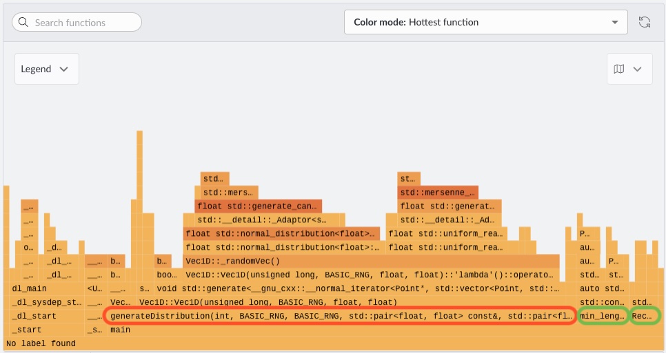

When the run completes, Performix displays the flame graph:
![Image Alt Text:Arm Performix flame graph for the baseline executable showing generateDistribution as the widest block at the base of the call stack, indicating it consumes the largest share of CPU time. The std::normal_distribution call path is visibly wider than std::uniform_real_distribution, identifying Gaussian sampling as the primary bottleneck.](https://learn.arm.com/learning-paths/servers-and-cloud-computing/openrng-with-performix/flame-graph.jpg)
The flame graph shows CPU time distribution across the call stack, where wider blocks indicate higher cumulative execution time. The dominant feature is the wide base associated with `generateDistribution(...)`, indicating it is the primary hotspot and consumes the largest share of execution time.
Focusing on that region, most of the work comes from standard library random generation routines, particularly paths involving `std::normal_distribution<float>`. Those stacks are visibly wider than those involving `std::uniform_real_distribution<float>`, indicating that Gaussian (normal) sampling is significantly more expensive in terms of CPU cycles than uniform sampling. The imbalance wouldn’t have been clear from higher-level instrumentation, because both operations conceptually generate random numbers but differ in computational cost.
By contrast, functions related to computing properties such as counting points within a rectangle or identifying a minimum point (for example, `min_length`-type operations) occupy relatively narrow regions of the graph. These functions contribute only a small fraction of total runtime and represent no meaningful bottleneck.
