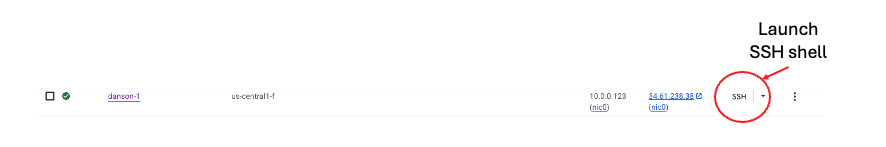

After the instance starts, select **SSH** next to the VM in the instance list to open a browser-based terminal session.
Alternatively, if you have the [gcloud CLI](https://learn.arm.com/install-guides/gcloud/) installed, you can connect from a local terminal using `gcloud`. From the **SSH** dropdown, select **View gcloud command** and run that command from your terminal.
![Connecting to a running C4A VM using SSH](https://learn.arm.com/learning-paths/servers-and-cloud-computing/openjdk-pacbti-gcp/images/gcp-ssh.png)
*Connecting to a running C4A VM using SSH*
A new browser window opens with a terminal connected to your VM.
