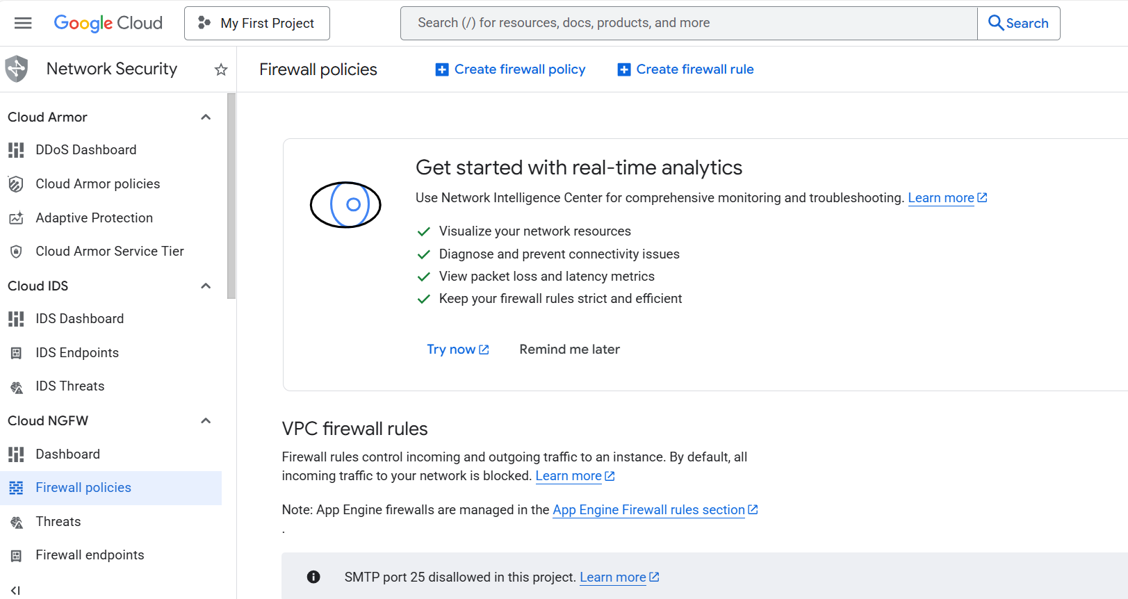

- Open the Google Cloud Console , navigate to VPC Network > Firewall, and select Create firewall rule.
Create a firewall rule in Google Cloud Console

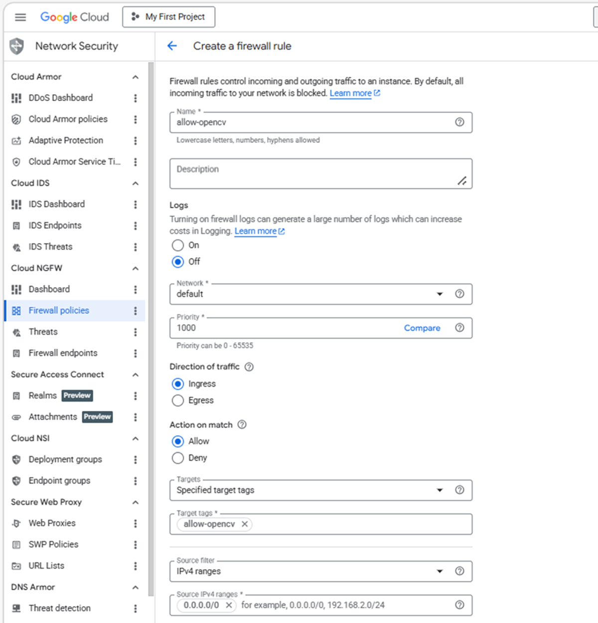

Set the Name of the new rule to allow-opencv-port. Select the network that you intend to bind to your VM.
For Direction of traffic, select Ingress.
For Allow on match, select Allow.
For Targets, select Specified target tags.
For Target tags, enter allow-opencv.
Set Source IPv4 ranges to your current machine’s public IP address. Run the following command in a terminal on your local machine to find the address:
curl -4 ifconfig.me
The -4 flag forces an IPv4 response. Take the returned address and append /32 to convert it to CIDR notation, for example 203.0.113.42/32. Restricting access to your own IP prevents port 8000 from being exposed to the public internet.
0.0.0.0/0 opens the port to all traffic and is not recommended.
Configuring the OpenCV firewall rule

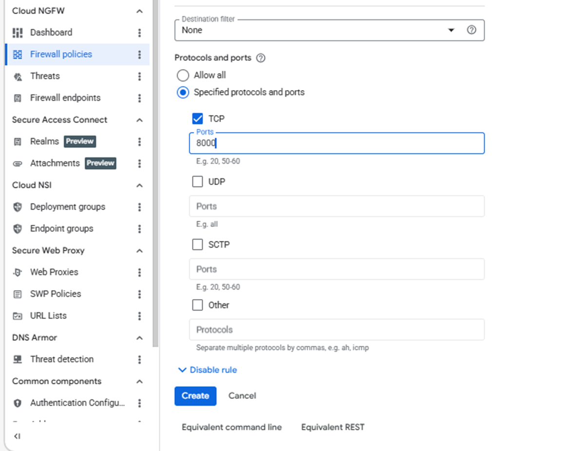

For Protocols and ports, select Specified protocols and ports.
Select the TCP checkbox and, for Ports, enter 8000.
Select Create.
Setting ports in the firewall rule
