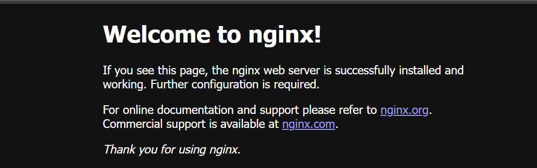

Access the NGINX welcome page
You can now access the NGINX welcome page from your VM’s public IP address. Run:
echo "http://$(curl -s ifconfig.me)/"
Copy the printed URL and open it in your browser. You should see the default NGINX welcome page as shown below, which confirms that HTTP traffic is reaching your VM:
Image Alt Text:NGINX default welcome page in a web browser on an Azure VM alt-text
At this stage, your NGINX installation is complete. You are ready to begin baseline testing and further configuration.
