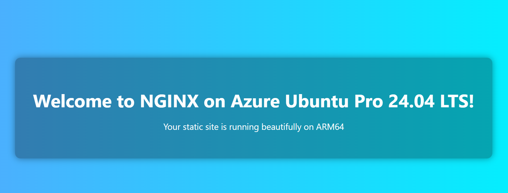

Test the static website in a browser
Access your website at your public IP on port 80:
http://<your-vm-public-ip>/

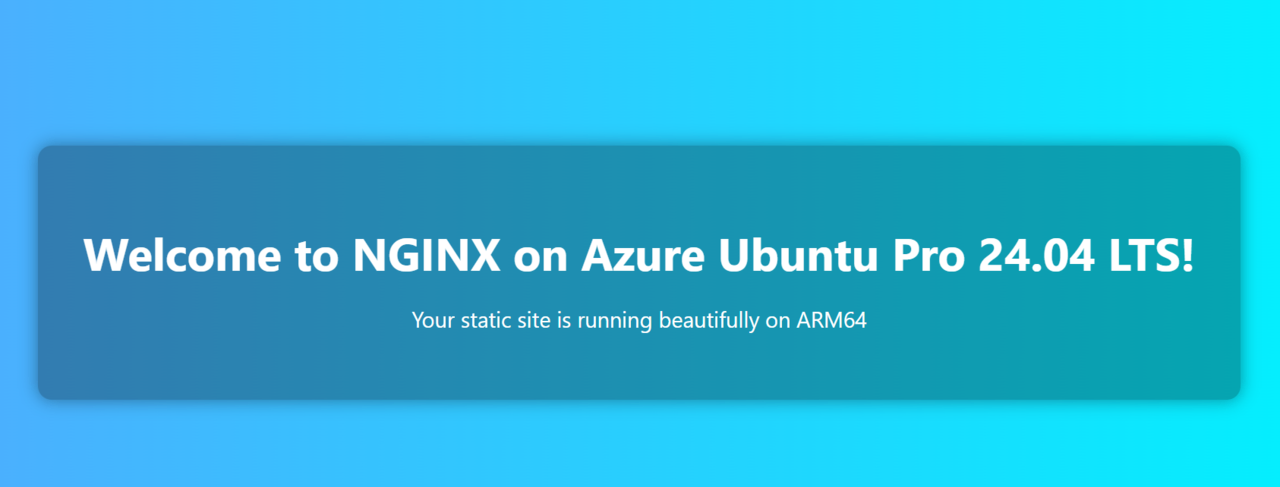

Verify the page renders
You should see your custom page instead of the default welcome page: Image Alt Text:Custom static website served by NGINX on Azure VM alt-textCustom static website served by NGINX on an Azure Arm64 VM
This verifies the basic functionality of the NGINX installation. You can now proceed to benchmarking NGINX performance on your Arm-based Azure VM.
