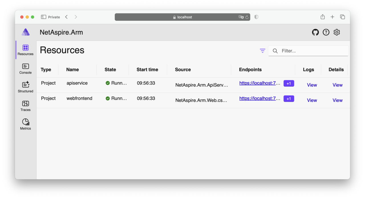

Login to the dashboard at https://localhost:17222/login?t=81f99566c9ec462e66f5eab5aa9307b0
Click on the link generated for the dashboard.
In this case, it is: https://localhost:17222/login?t=81f99566c9ec462e66f5eab5aa9307b0 .
This directs you to the application dashboard, as Figure 1 shows:
Figure 1: Application Dashboard.
On the dashboard, locate and click the endpoint link for NetAspire.Arm.Web

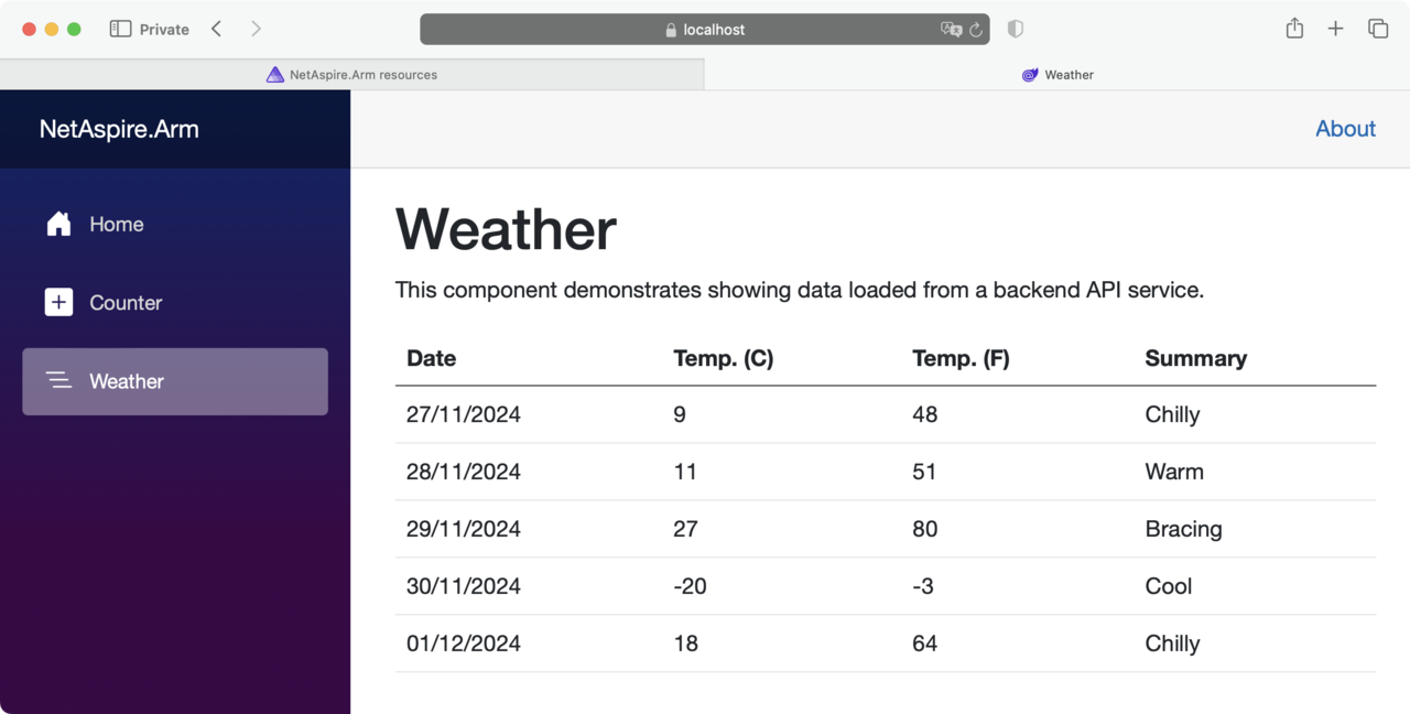

This takes you to the Blazor-based web application. In the Blazor app, navigate to the Weather section to access and display data retrieved from the WeatherForecast API:
Figure 2: Data Displayed from WeatherForecast API.

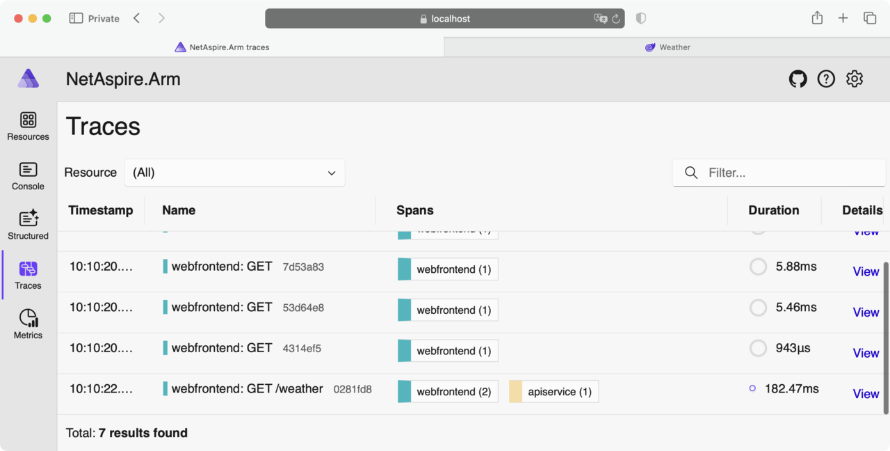

Now return to the dashboard, and select the Traces option. This section provides detailed telemetry tracing, allowing you to view the flow of requests, track service dependencies, and analyze performance metrics for your application:
Figure 3: Traces.
By following these steps, you can explore the key components of the .NET Aspire application, including its dashboard, data interaction through APIs, and telemetry tracing capabilities.
