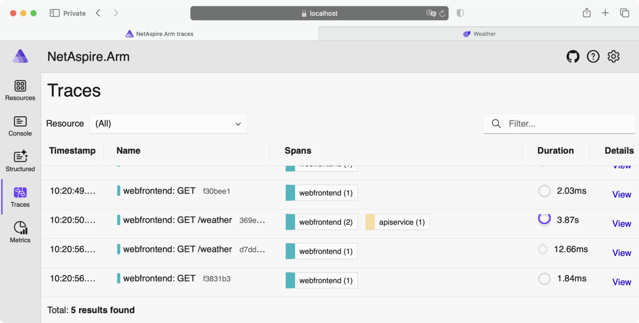

This triggers matrix multiplications when you select Weather in the web-frontend application.
To test the code, re-run the application using the following command:
dotnet run --project NetAspire.Arm.AppHost
Next, navigate to the web frontend, select Weather, and then return to the dashboard. Click Traces and note that the operation now takes significantly longer to complete — approximately four seconds in the example below:
Figure 4: Traces Example.
