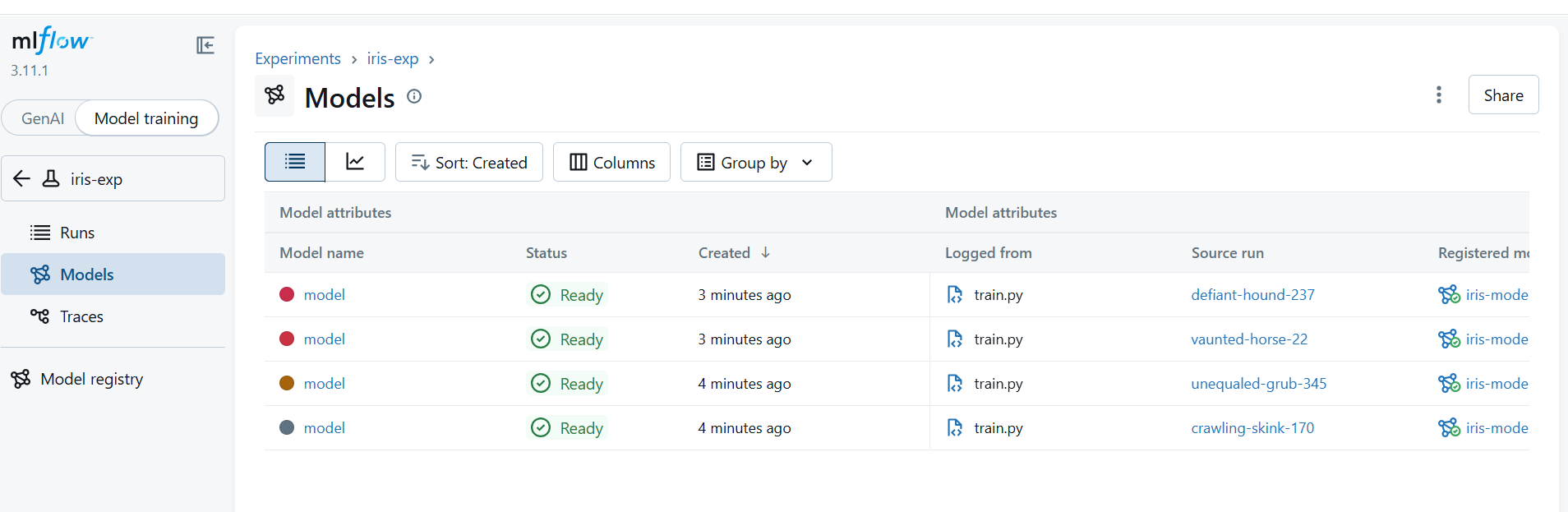

## View registered models
In the MLflow UI at `http://<VM-IP>:5000`, select the **Models** tab. You should see the `iris-model` entry with multiple registered versions and the `production` alias assigned to the best-performing one.
![MLflow Model Registry showing iris-model with multiple registered versions and the production alias visible next to the best-performing version in the versions table](https://learn.arm.com/learning-paths/servers-and-cloud-computing/mlflow-axion/images/mlflow-model.png)
