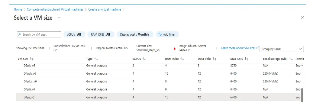

  • In the Size field, select See all sizes and select the D-Series v6 family of virtual machines.
  • Select D4ps_v6 from the list as shown in the diagram below:
Image Alt Text:Azure Portal VM size selection showing the D-Series v6 (Dpsv6) family highlighted with D4ps_v6 option selected for Arm64 architectureSelect D4ps_v6 from the D-Series v6 family

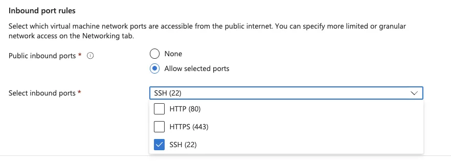

  • In the Inbound port rules, select SSH (22) as the inbound port.
Security
Azure sets the source to Any by default, which allows SSH connections from the entire internet. After creating the VM, update the SSH inbound rule in the Network Security Group to restrict the source to your own IP address.
Image Alt Text:Azure Portal inbound port rules configuration showing SSH (22) selected as the allowed incoming portConfigure inbound port rules for SSH access

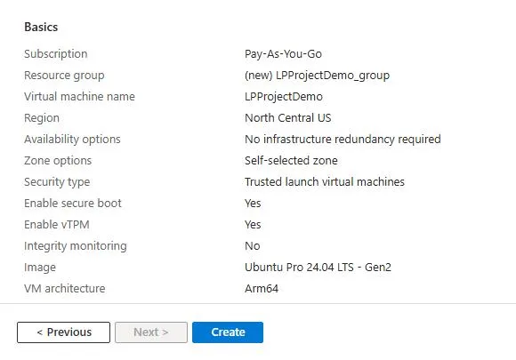

  • Select the Review + Create tab and review the configuration for your virtual machine. It should look like the following:
Image Alt Text:Azure Portal Review + Create tab showing VM configuration summary with Ubuntu Pro 24.04 LTS image, D4ps_v6 size, and networking settings configuredReview VM configuration before creation

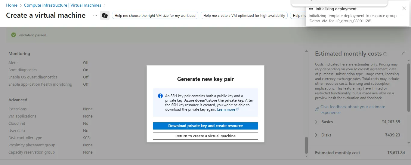

  • Review the configuration and select the Create button, then select Download Private key and Create Resource.
Image Alt Text:Azure Portal showing the Create button and Download Private key and Create Resource button to finalize VM creationDownload SSH key and create the virtual machine

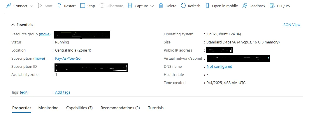

Your virtual machine should be ready and running in a few minutes. You can SSH into the virtual machine using the private key, along with the public IP details.
Image Alt Text:Azure Portal showing successful VM deployment with green checkmark, VM name, resource group, and public IP address displayed in the confirmation notificationSuccessful VM deployment confirmation
