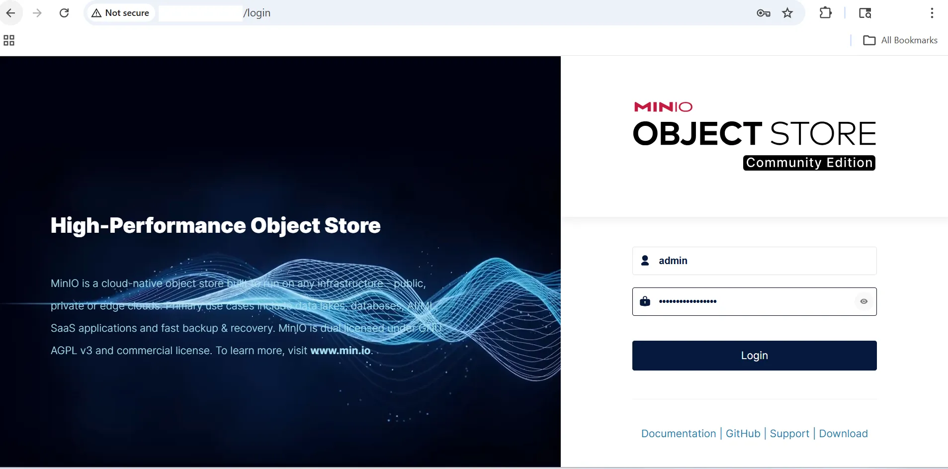

Open a browser and navigate to http://<VM-IP>:9001, replacing <VM-IP> with your virtual machine’s public IP address. This opens the MinIO web console. The S3-compatible API is also available on port 9000 for use with SDKs and CLI tools.
Log in with username admin and the password you set in MINIO_ROOT_PASSWORD.
Image Alt Text:MinIO web console login page showing the username and password fieldsMinIO web console login page

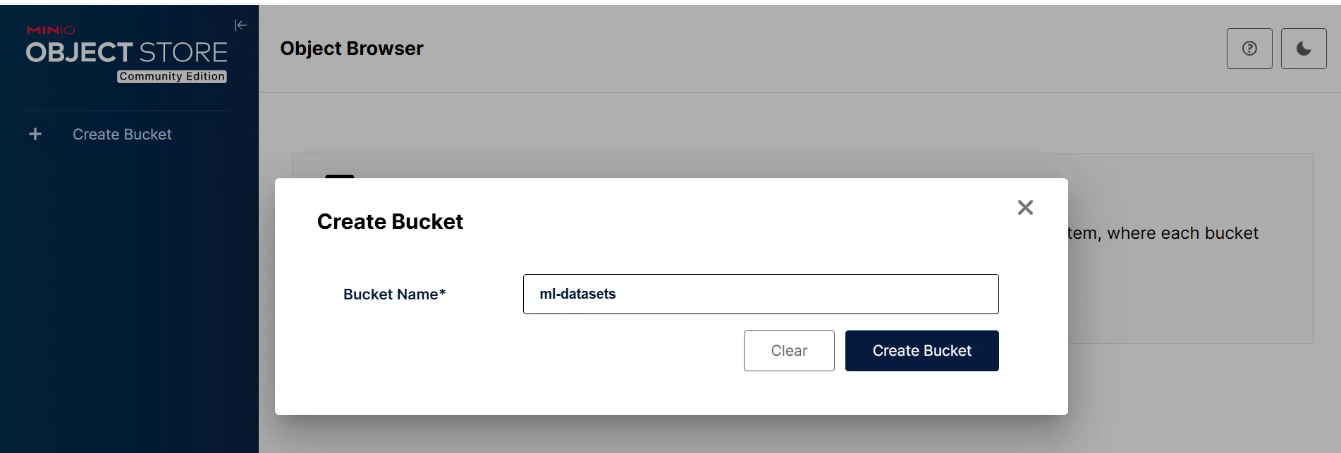

Buckets are the containers you use to store objects in MinIO. To create one:
  • Select Buckets in the left menu.
  • Select Create Bucket.
  • Enter ml-datasets as the bucket name and select Create Bucket.

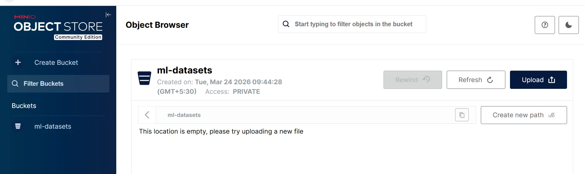

Image Alt Text:MinIO console showing the Create Bucket form with the bucket name fieldCreate a bucket in MinIO
Image Alt Text:MinIO console showing the ml-datasets bucket successfully createdml-datasets bucket created

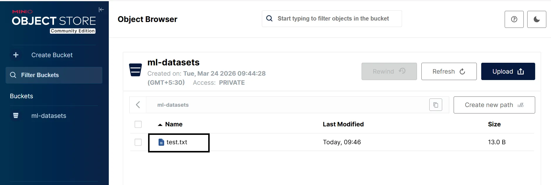

Image Alt Text:MinIO console showing test.txt uploaded to the ml-datasets bucketObject uploaded to MinIO
