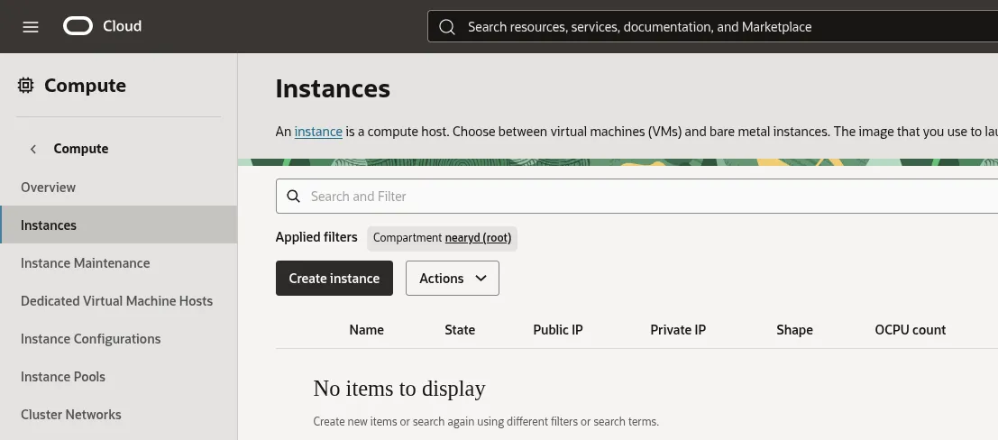

2. On the Oracle Cloud Infrastructure (OCI) dashboard, go to **Compute > Instances** to start a new instance:
   ![](https://learn.arm.com/learning-paths/servers-and-cloud-computing/minecraft-on-oci/oci_compute_dashboard.webp "Navigate to Compute -> Instances in the OCI dashboard")
   Navigate to Compute -&gt; Instances in the OCI dashboard
3. Select **Create instance**.

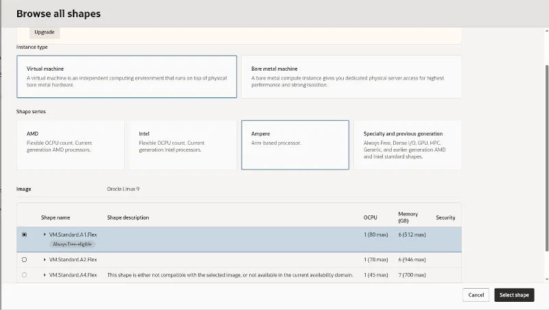

8. To update the shape of the instance, select **Change shape** and update the following in the **Browse all shapes** panel:
   - For **Instance type**, select **Virtual machine**.
   - For **Shape series**, select **Ampere**.
   - For **Image**, select **VM.Standard.A1.Flex**.
   - Allocate two OCPUs and 12 GB of memory to your instance.
   ![](https://learn.arm.com/learning-paths/servers-and-cloud-computing/minecraft-on-oci/oci_change_shape.webp "Configure the VM instance shape to VM.Standard.A1.Flex")
9. After updating the instance shape, select **Select shape**.

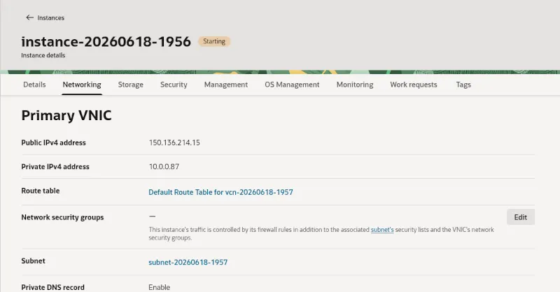

1. On the **OCI Instances** page, choose the Minecraft server instance.
2. Under the **Networking** tab, select the subnet name.
   ![](https://learn.arm.com/learning-paths/servers-and-cloud-computing/minecraft-on-oci/oci_instance_networking.webp "Open the subnet from the instance Networking tab")

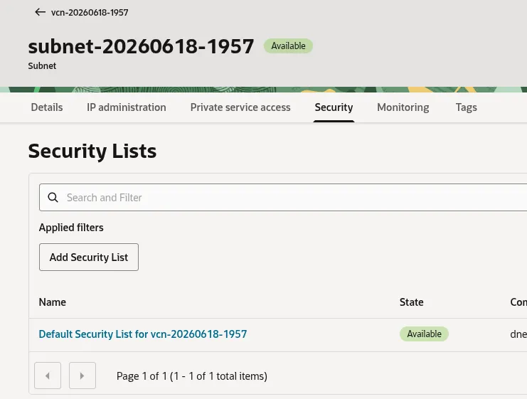

3. Under the **Security** tab of the subnet page, choose the security list which is active for the instance. By default, this is called **Default Security List for vcn-xxxxxxxx**.
   ![](https://learn.arm.com/learning-paths/servers-and-cloud-computing/minecraft-on-oci/subnet_security_list.webp "Select the Default Security List on the Subnet Details page")

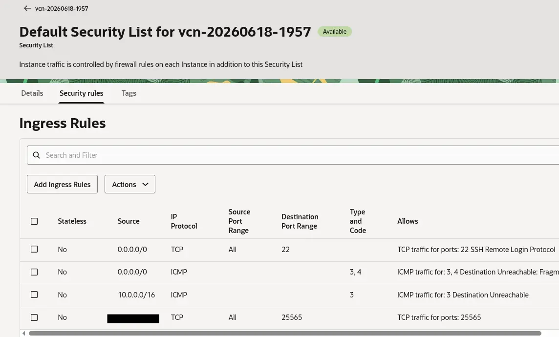

4. Under **Security rules**, select **Add Ingress Rules** to add a new ingress rule, then update the following:
   - Set **Source CIDR** to the public IP address (or range) of the players who’ll connect to your server. For example, if your home IP address is `203.0.113.45`, set the Source CIDR to **203.0.113.45/32** to allow only that address.
     You can find your current public IP address by searching “what is my IP address?” in a web browser from the network you’ll use to connect. You can add multiple ingress rules if players connect from different networks.
   ![Warning](https://learn.arm.com/learning-paths/servers-and-cloud-computing/minecraft-on-oci/open_minecraft_port.webp "Security list ingress rule for Minecraft traffic on port 25565")
   ```plaintext
   Avoid using `0.0.0.0/0` as the **Source CIDR**. `0.0.0.0/0` opens the port to the entire internet and exposes your server to unauthorized access attempts. Always restrict access to only the IP addresses that need to connect.
   - Set the **Destination Port Range** field to **25565**.

After creating the instance and opening a port for the Minecraft server, navigate to the **Networking** tab for the instance:
![Find the instance public IPv4 address](https://learn.arm.com/learning-paths/servers-and-cloud-computing/minecraft-on-oci/oci_instance_networking.webp "Find the instance public IPv4 address")
Note the IP address under **Public IPv4 address**.
SSH into your instance, replacing `<path to private key>` with the path to your SSH private key and `<public IPv4 address>` with the instance’s public IP:
```bash
ssh -i <path to private key> opc@<public IPv4 address>
