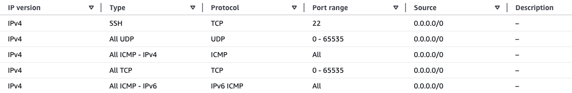

If you’re working in a cloud environment like AWS, you must update the default security rules to enable specific inbound and outbound protocols.
To do this, follow these instructions below using the AWS console:
ICMP (for ping)
AWS console view
For secure internal communication, set the source to your instance’s security group. This avoids exposing traffic to the internet while allowing traffic between your systems.
You can restrict the range further by:
Opening only TCP port 5201
Allowing all UDP ports (or a specific range)
