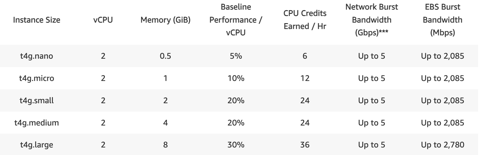

Bitrate shows the throughput achieved. In this example, the the t4g.xlarge AWS instance saturates its 5 Gbps bandwidth available.
Instance network size
