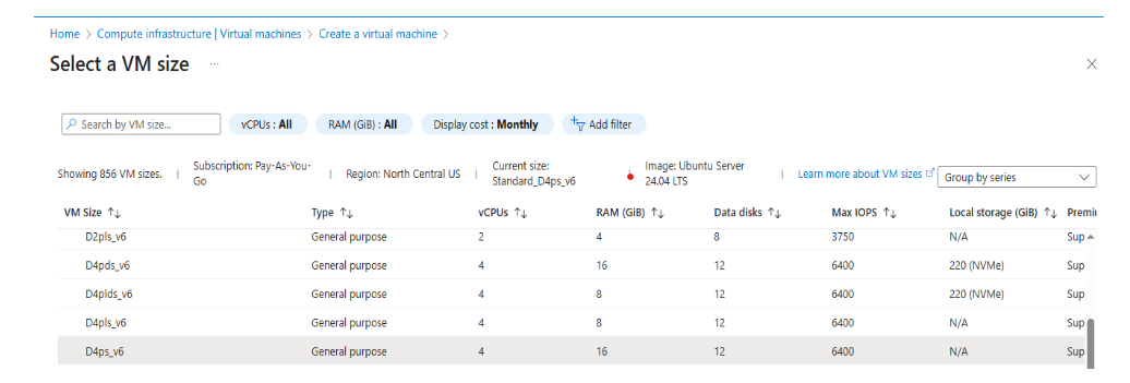

- In the Size field, select See all sizes and select the D-Series v6 family of VMs.
- Select D4ps_v6 from the list as shown in the following screenshot:
Select D4ps_v6 from the D-Series v6 family

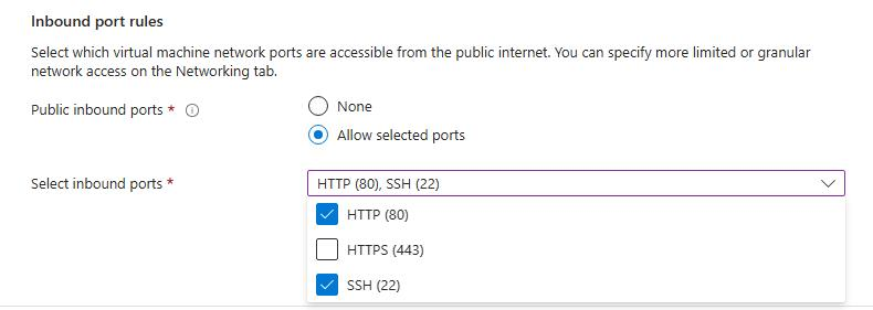

- In the Inbound port rules, select HTTP (80) and SSH (22) as the inbound ports, as shown in the following image:
Configure inbound port rules for HTTP and SSH access

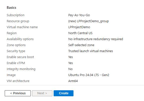

- Select the Review + Create tab and review the configuration for your virtual machine. It should look like the following:
Review VM configuration before creation

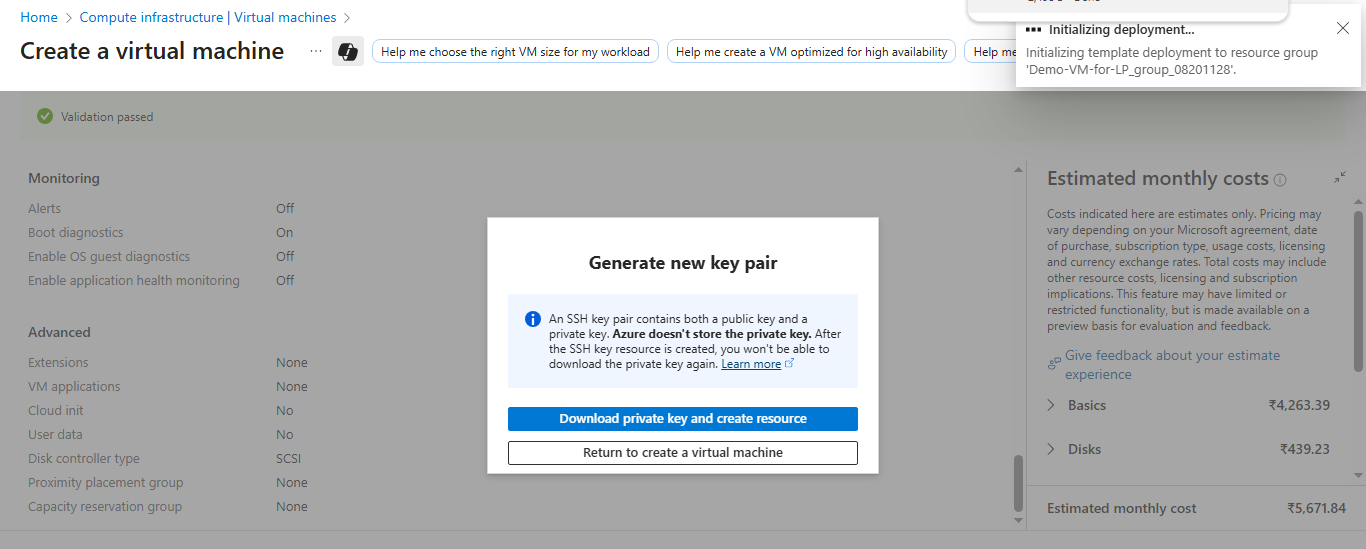

- When you’re happy with your selection, select the Create button and then Download Private key and Create Resource.
Download SSH key and create the virtual machine

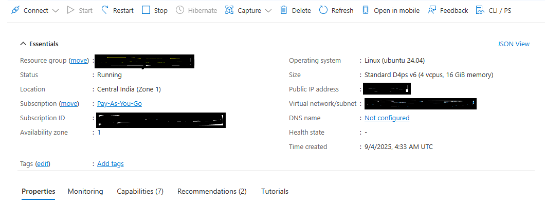

Your virtual machine should be ready and running in a few minutes. You can SSH into the virtual machine using the private key, along with the public IP details.
Successful VM deployment confirmation
