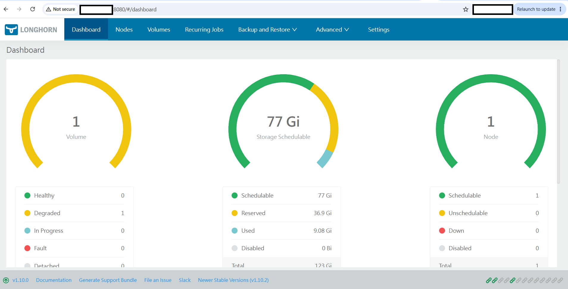

Open the Longhorn web UI in your browser. Replace `<PUBLIC_IP>` with the public IP address of your Azure VM.
```bash
http://<PUBLIC_IP>:8080
![Longhorn UI Dashboard with storage and node summary](https://learn.arm.com/learning-paths/servers-and-cloud-computing/longhorn-cobalt/images/longhorn-ui.png)
In the Longhorn dashboard, you can view the number of volumes, available schedulable storage, node status, and overall storage health.

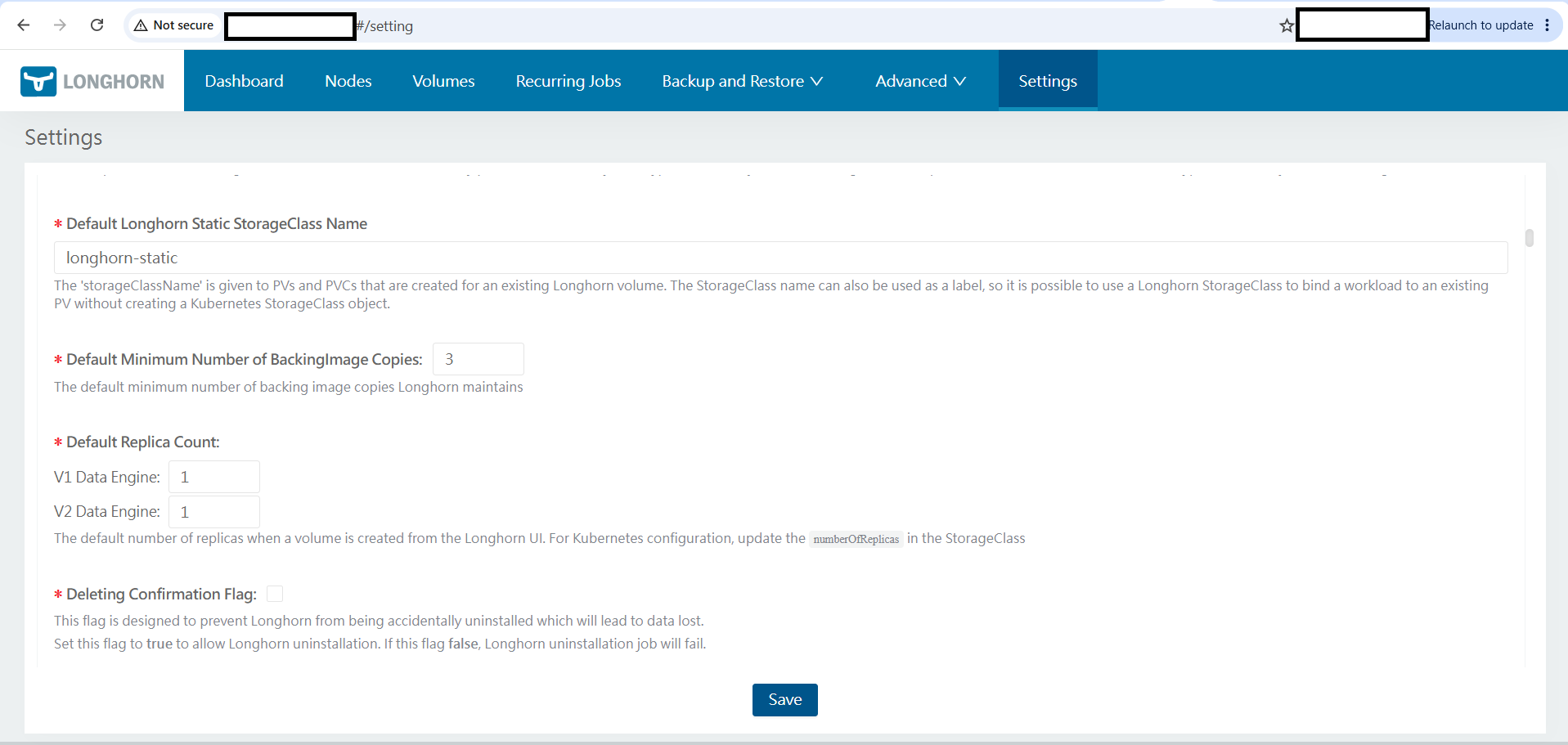

## Configure Longhorn for a single-node cluster
By default, Longhorn expects multiple nodes and uses a higher replica count. Because you’re using a single VM in this Learning Path, configure the replica count to `1` so that volumes can be scheduled on a single node.
To configure the replica count, follow these steps:
1. In the Longhorn UI, select **Settings**.
2. Find the **Default Replica Count** setting and set both **V1 Data Engine** and **V2 Data Engine** to `1`.
3. Select **Save**.
![Longhorn Replica configuration for single-node Kubernetes cluster](https://learn.arm.com/learning-paths/servers-and-cloud-computing/longhorn-cobalt/images/longhorn-replica.png)
This configuration allows Longhorn volumes to be scheduled successfully on a single-node Kubernetes cluster.
