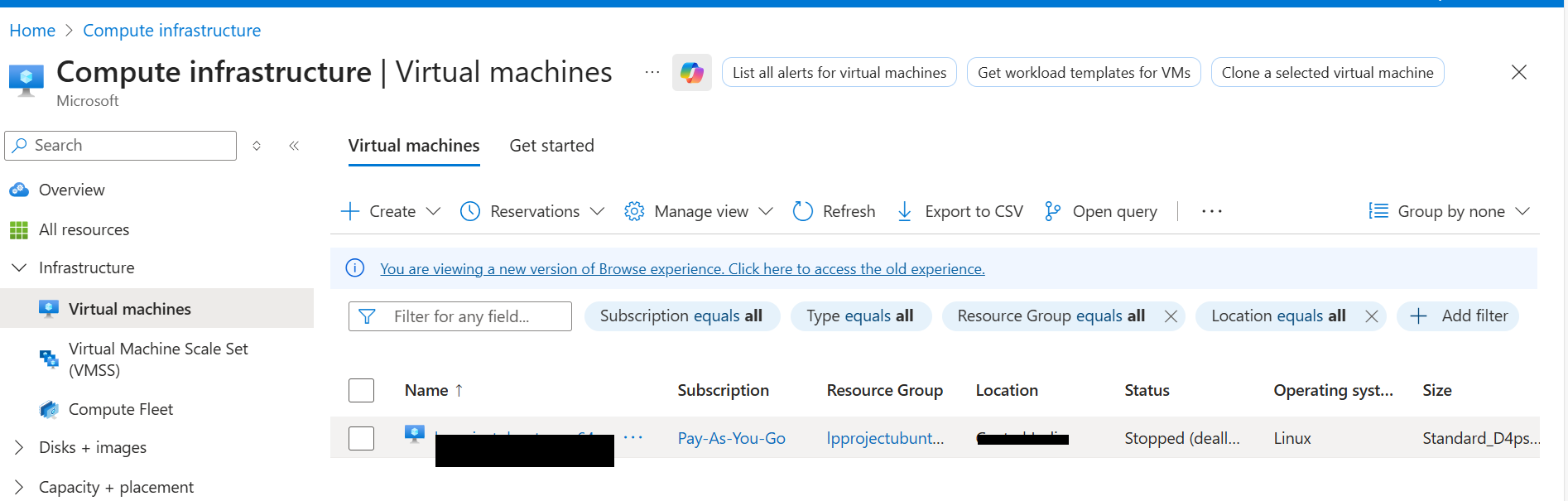

- Navigate to the Azure portal , go to Virtual Machines, and select your VM.
Azure Virtual Machine

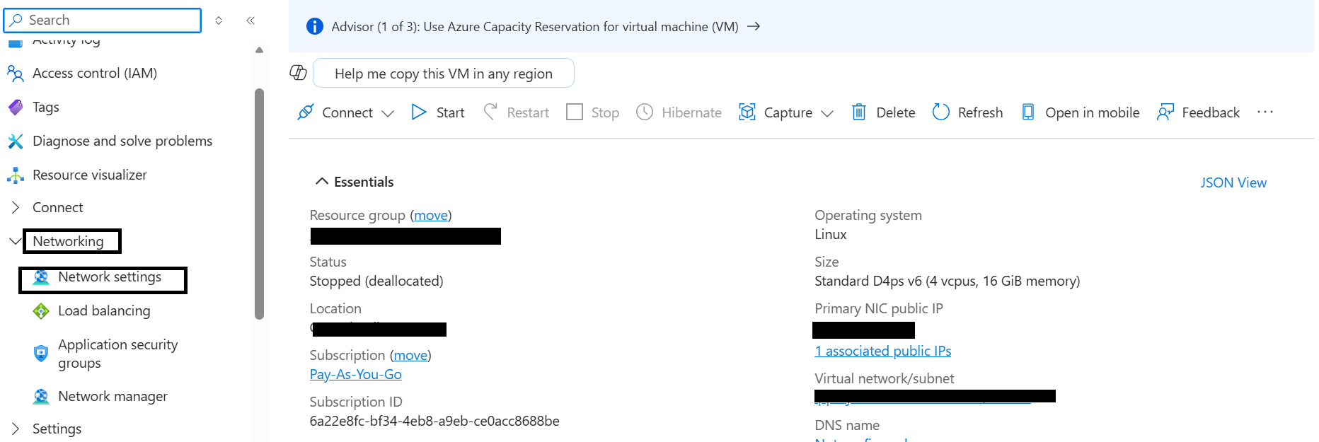

- In the left menu, select Networking, then select Network settings.
Azure Networking Settings

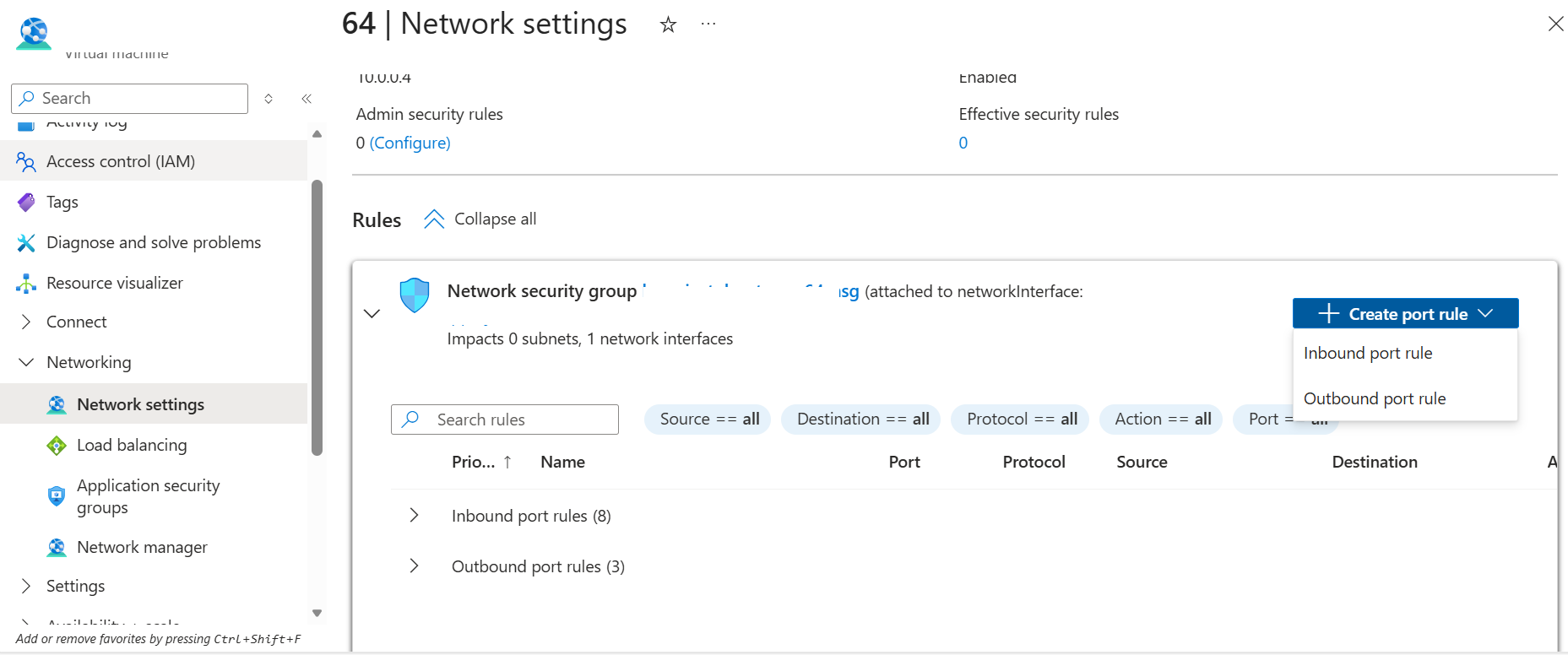

- Navigate to Create port rule, and select Inbound port rule.
Create Inbound Port Rule
