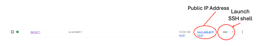

After the instance starts, select SSH next to the VM in the instance list to open a browser-based terminal session.
Connecting to a running C4A VM using SSH
A new browser window opens with a terminal connected to your VM.
