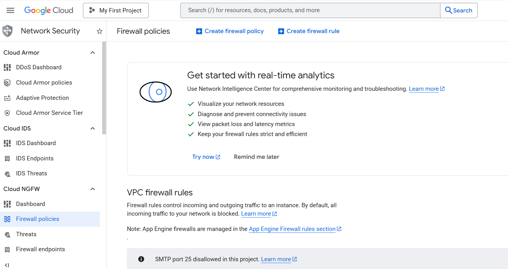

- Navigate to the Google Cloud console .
- Go to VPC Network > Firewall, and select Create firewall rule.

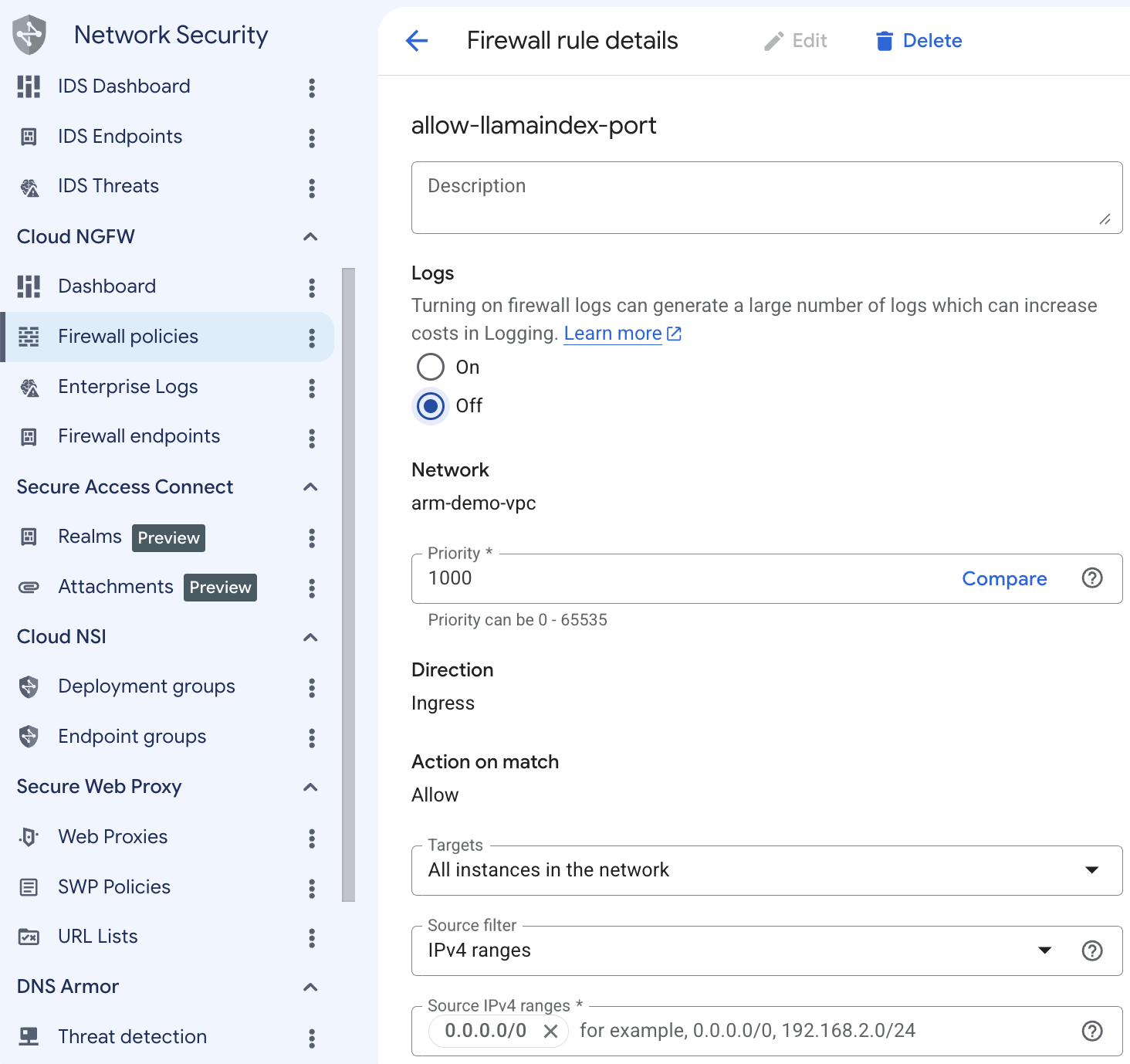

Create a firewall rule in Google Cloud console
- Set Name to
allow-llamaindex-port, then select the network you want to bind to your virtual machine. - Set Direction of traffic to Ingress, set Action on match to Allow, set Targets to All instances in the network, and set Source IPv4 ranges to 0.0.0.0/0.
Configuring the allow-llamaindex-port firewall rule

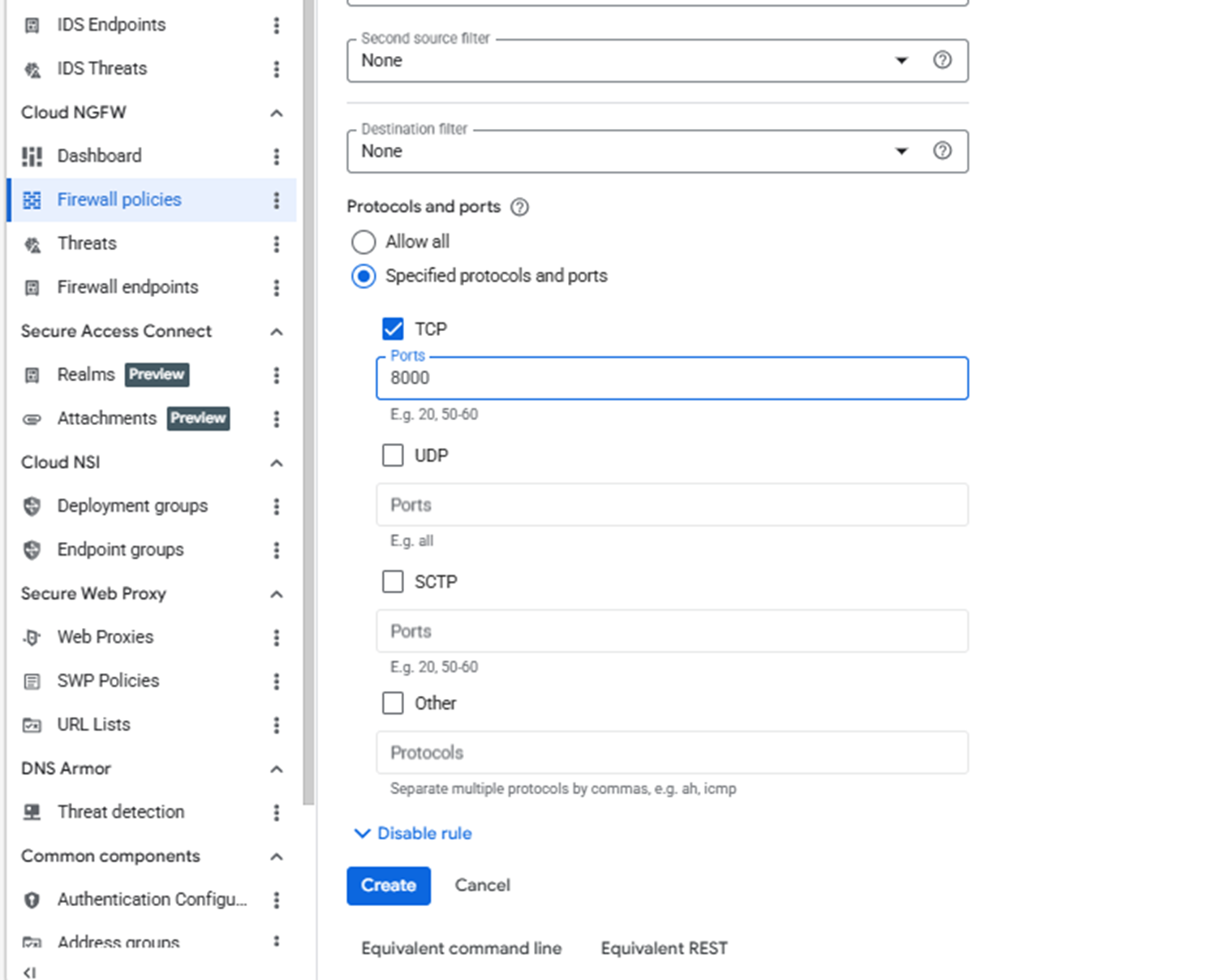

- Under Protocols and ports, select Specified protocols and ports.
- Select the TCP checkbox. For Ports, enter
8000. Port8000is used by the FastAPI server that backs the browser-based LlamaIndex RAG application.
Setting the LlamaIndex browser application port in the firewall rule
- In the same TCP field, also add port
22to allow SSH access to the VM. - Select Create.
