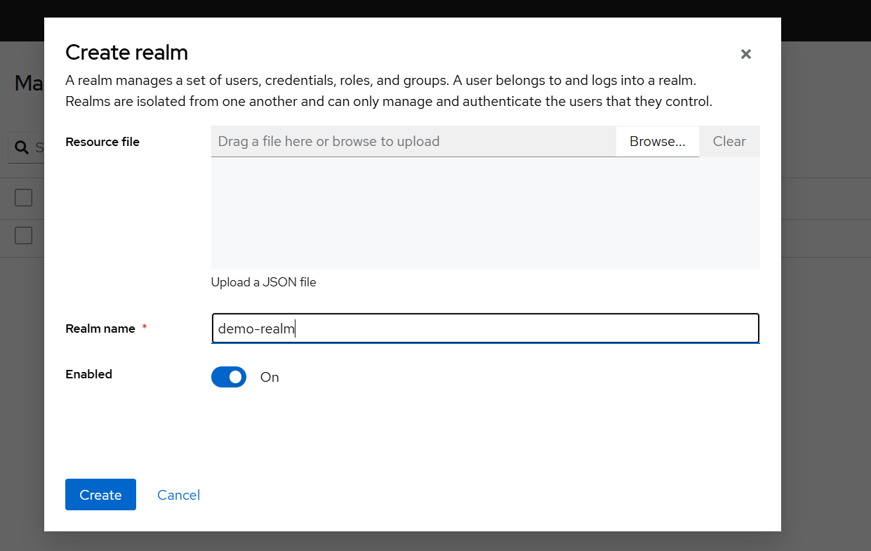

Create a realm
Create a dedicated realm for the Flask OAuth2 demo application.
In the admin console:
- Select Manage Realms.
- Select Create realm.
- Enter
demo-realmas the realm name. - Select Create.
Keycloak Create Realm configuration page

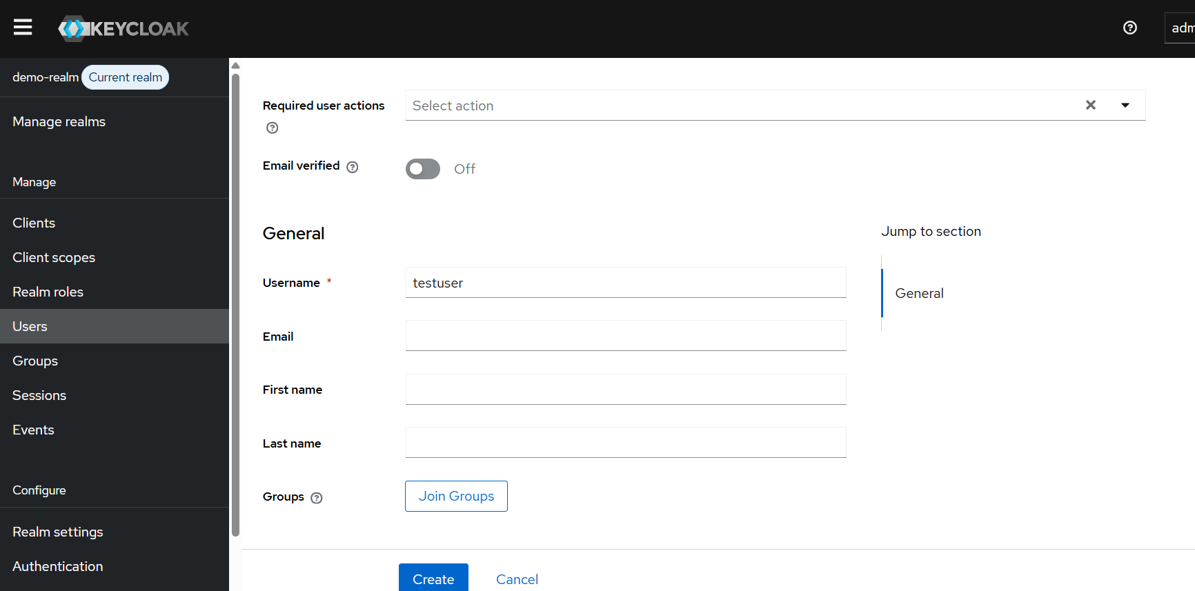

Create a user
Create a user in the demo-realm for testing OAuth2 authentication:
- Navigate to Users and select Create new user.
- Set the username to
testuserand select Create. - After the user is created, navigate to Credentials and select Set password.
- Enter a password of your choice and disable the temporary password setting.
Keycloak user creation page for demo-realm

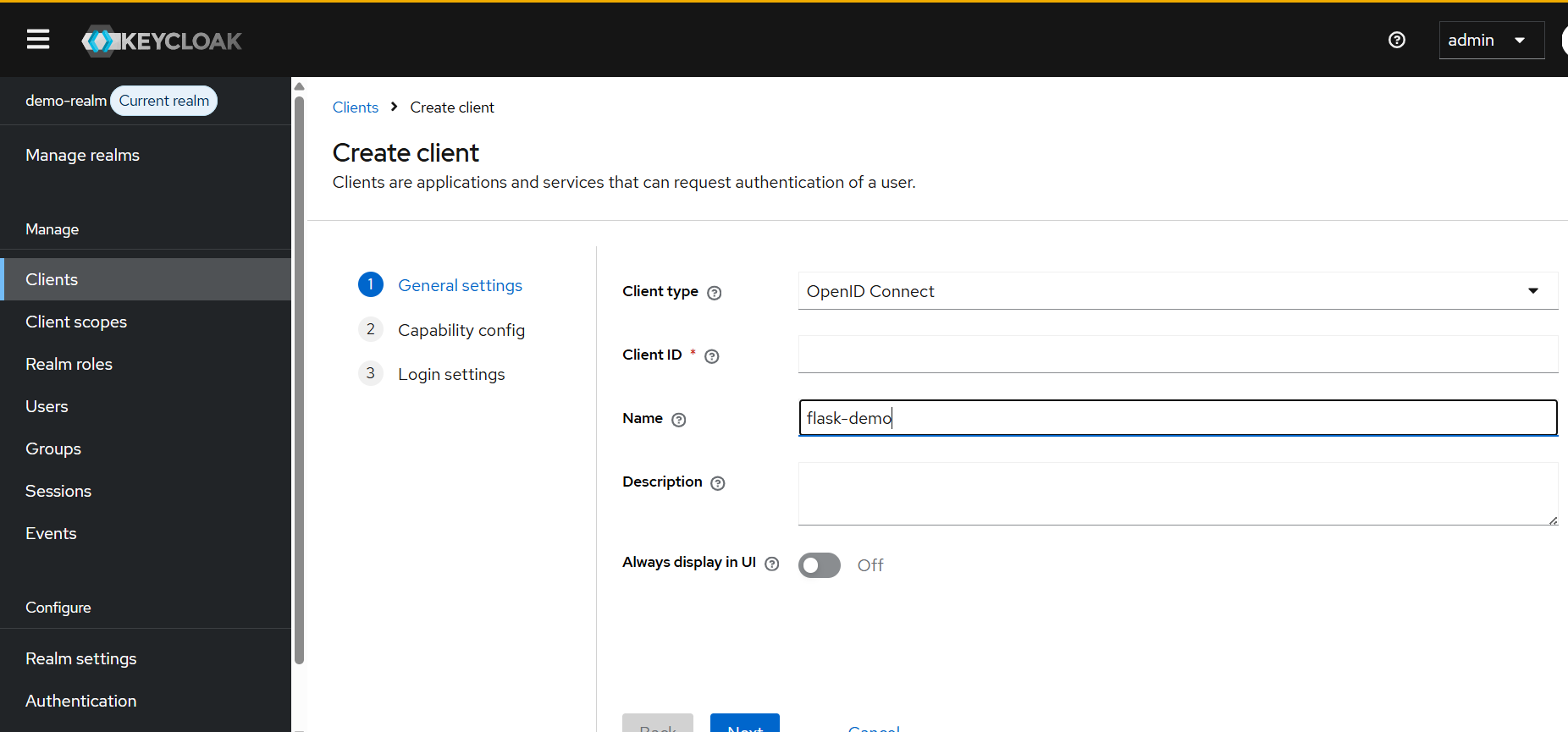

Create an OpenID Connect client
Create a Keycloak client for the Flask application:
- Navigate to Clients and select Create client.
- In General Settings, enter:
Client type: OpenID Connect
Client ID: flask-demo
- Under Capability config, enter:
Client authentication: Off
Authorization: Off
- Under Login settings, set the Valid redirect URI:
http://YOUR_PUBLIC_IP:5000/*
- Save the client.
Keycloak OpenID Connect client configuration for Flask demo application

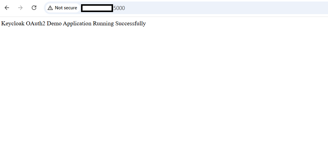

Run the Flask application
Start the Flask application with the Keycloak URL pointing to localhost:
KEYCLOAK_URL=http://localhost:8080 python app.py
The Flask application connects to Keycloak locally on the VM. The browser redirects use the public IP automatically, because Keycloak’s hostname setting controls the URLs returned in the discovery document.
Open the application in your browser. Replace YOUR_PUBLIC_IP with the public IP address of your Azure VM:
The home page shows a login link. Select the link to be redirected to the Keycloak login page. After authenticating as testuser, you’re redirected back to the Flask application and the page displays the logged-in username.
Logged in as: testuser
Flask OAuth2 demo application authenticated through Keycloak
