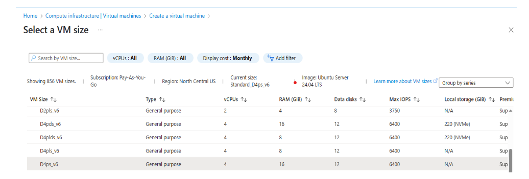

5. In the **Size** field, select **See all sizes** and select the D-Series v6 family of virtual machines.
6. Select **D4ps_v6** from the list as shown in the following screenshot:
   ![Select D4ps_v6 from the D-Series v6 family](https://learn.arm.com/learning-paths/servers-and-cloud-computing/keycloak-cobalt/images/instance.png)
   *Select D4ps_v6 from the D-Series v6 family*

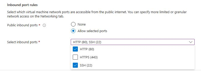

11. Under **Inbound port rules**, select **HTTP (80)** and **SSH (22)** as the inbound ports, as shown in the following screenshot:
    ![Configure inbound port rules for HTTP and SSH access](https://learn.arm.com/learning-paths/servers-and-cloud-computing/keycloak-cobalt/images/instance1.png)
    *Configure inbound port rules for HTTP and SSH access*

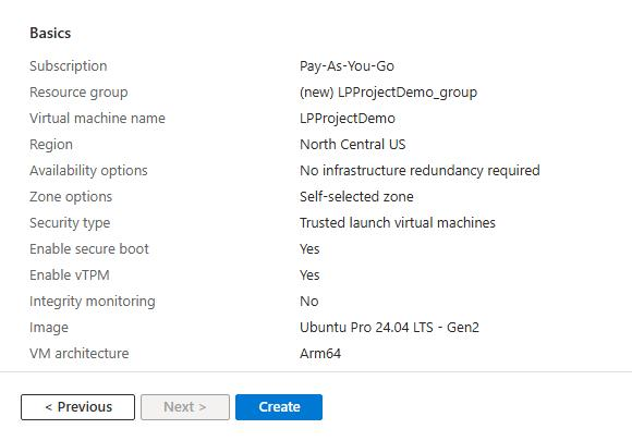

12. Select the **Review + Create** tab and review the configuration for your virtual machine. It should look like the following:
    ![Review VM configuration before creation](https://learn.arm.com/learning-paths/servers-and-cloud-computing/keycloak-cobalt/images/ubuntu-pro.png)
    *Review VM configuration before creation*

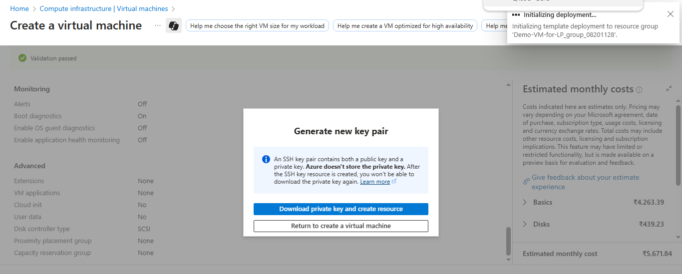

13. When you’re happy with your selection, select the **Create** button and then **Download private key and create resource**.
    ![Download SSH key and create the virtual machine](https://learn.arm.com/learning-paths/servers-and-cloud-computing/keycloak-cobalt/images/instance4.png)
    *Download SSH key and create the virtual machine*

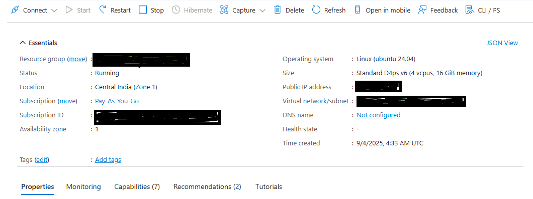

Your VM should be ready and running in a few minutes. You can SSH into the virtual machine using the private key, along with the public IP details.
![Successful VM deployment confirmation](https://learn.arm.com/learning-paths/servers-and-cloud-computing/keycloak-cobalt/images/final-vm.png)
*Successful VM deployment confirmation*
